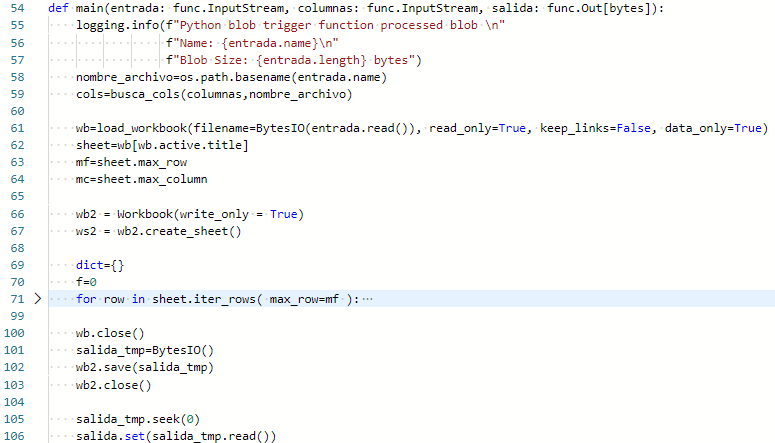

I had to modify an Azure function, so i deployed a copy of it from my VSCode. I didn´t realize that I was overwriting all the App Files of the original Azure Function. For example, the host.json file was modified.
The output of my function creates a blob in a container. My issue strats here. I have a trigger (Storage event) in Azure Data Factory that executes a pipeline when the blob is created. However, after I deployed the function and lost the App Files, the trigger is detecting two events.
I suspect this is due to a temporary file being created in the container while the blob finishes. So the blob runs the trigger (eventhough it has no bytes) and then runs again.
Best Regards,
Marco.
