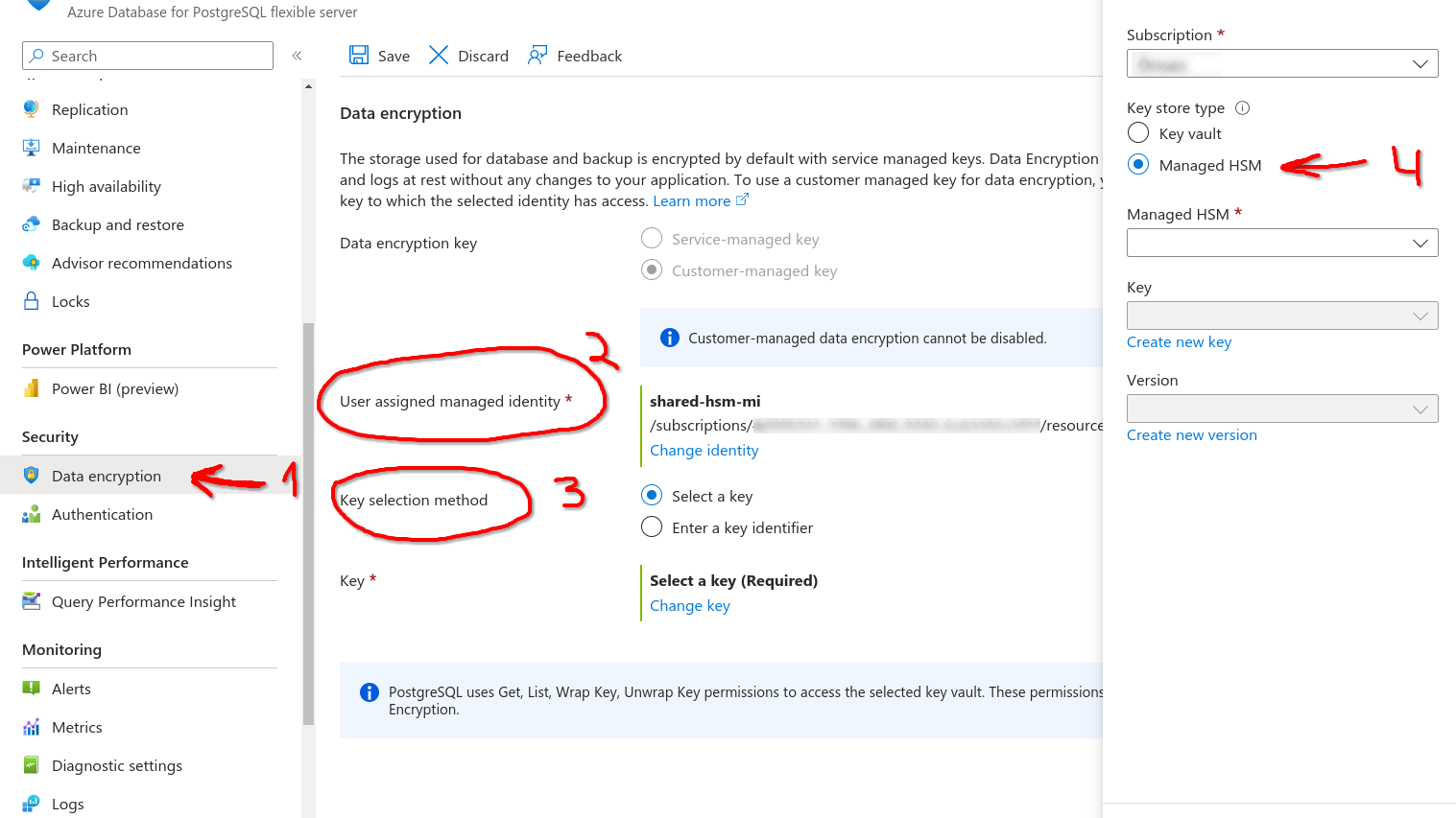

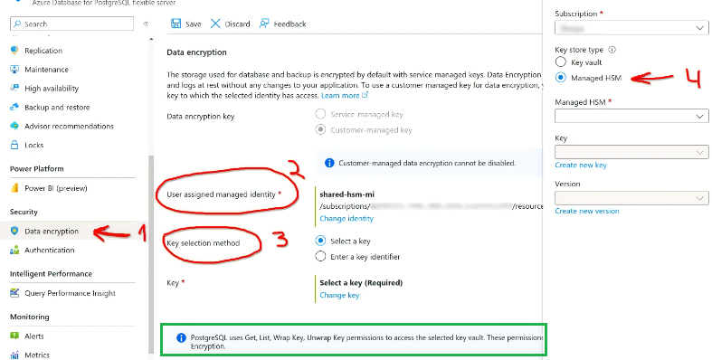

Your advice is highly appreciated. I'm having trouble with granting permissions to Imported rsa keys in Azure Managed HSM.
I wish to use our own generated RSA keys for PostgreSQL flexible server for Data encryption in Azure. What have I done so far:
  • I have enabled and configured Azure Key Vault Managed HSM.
  • Created a new User assigned managed identity

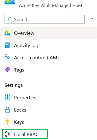

  • Granted 'Managed HSM Crypto Service Encryption User' role to the managed identity in the HSM Local RBAC with the scope '/'
  • I have generated 2048 bit RSA key with ssh-keygen
  • I have imported the key into the HSM Keys
Now when I try to use the Imported key, I use the created Managed Identity and then select the imported key from the Managed HSM, but get:
AzureKeyVaultMissingPermissions The server requires following Azure Key Vault permissions: 'Get, WrapKey, UnwrapKey'. Please grant any missing permissions to the service principal with ID ...
For testing I Generated a new RSA key and I can use the Generated RSA key with the same length in the same Managed HSM. Visually the keys look the same.
I have been searching and reading the documentation, but can't figure out what am I missing?
Thank you!!!

    Findings:
    I'm not too familiar with PostgreSQL flexible server but from the Key Vault side of things, it sounds like you configured everything correctly, since you created a new role assignment, and assigned the Managed HSM Crypto Service Encryption User role to your Managed Identity (for your KV), which would then give it the correct wrap/unwrap permissions.
    When reviewing the steps that you've taken so far, I noticed that you created a new user-assigned managed identity and granted this managed identity the correct Crypto Service Encryption User RBAC role. However, from your error it mentions the server requiring the permissions - did you also make sure to assign the user-assigned managed identity to your PostgreSQL flexible server?
    • If you're still having issues, the Service Principal ID within your error message, is that the same ID as your Managed Identity?
