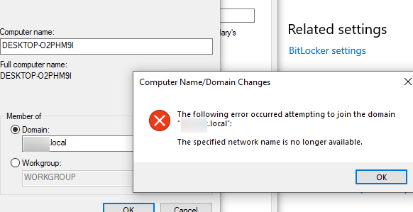

When I tried to add a computer to the domain I had it:
The domain controller and this computer are in the same network.
They can ping together and DNS on the computer is set on DC.

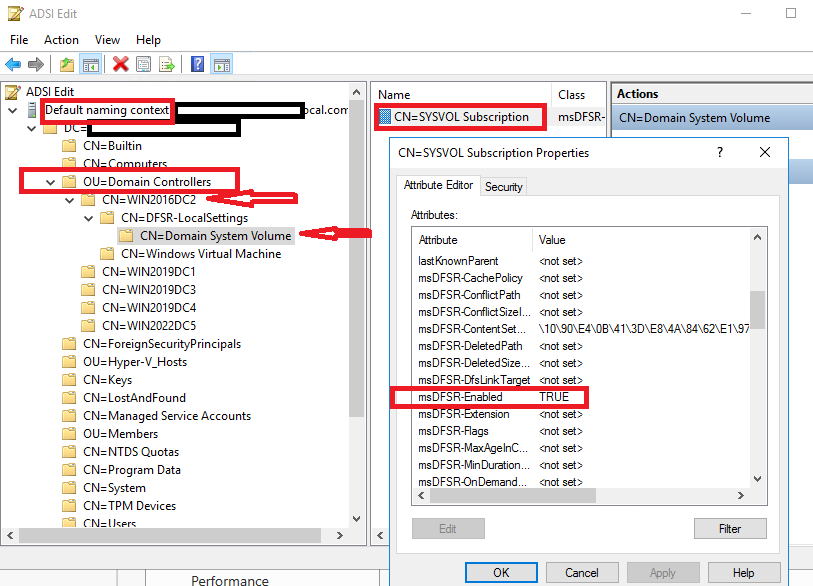

    On AD remove the address 172.0.0.1 listed for DNS and add the server's own static ip address (10.11.11.11) plus the loopback address 127.0.0.1 then do ipconfig /flushdns, ipconfig /registerdns, restart the netlogon service. For the replication error since a single domain controller you can try an authoritative sync
    https://learn.microsoft.com/en-US/troubleshoot/windows-server/group-policy/force-authoritative-non-authoritative-synchronization#how-to-perform-an-authoritative-synchronization-of-dfsr-replicated-sysvol-replication-like-d4-for-frs
    if problems persist then put up a new set of files to look at.
