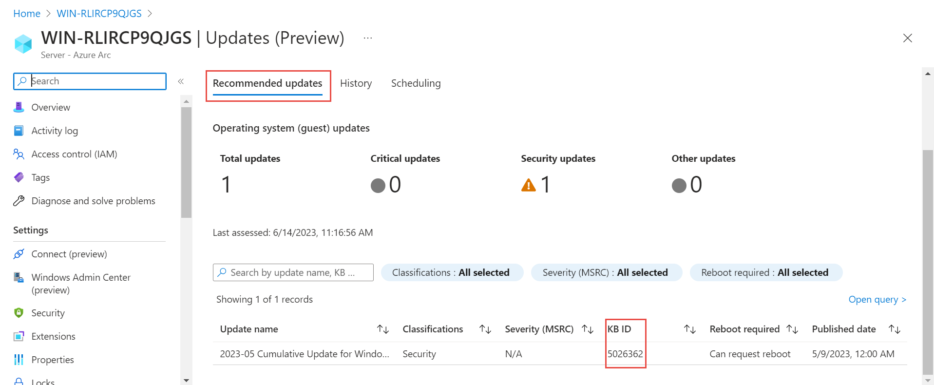

I have installed update in my lab vm connected to Azure via Azure Arc. However, when I check the history from Azure portal I see that all the updates are successfully installed.

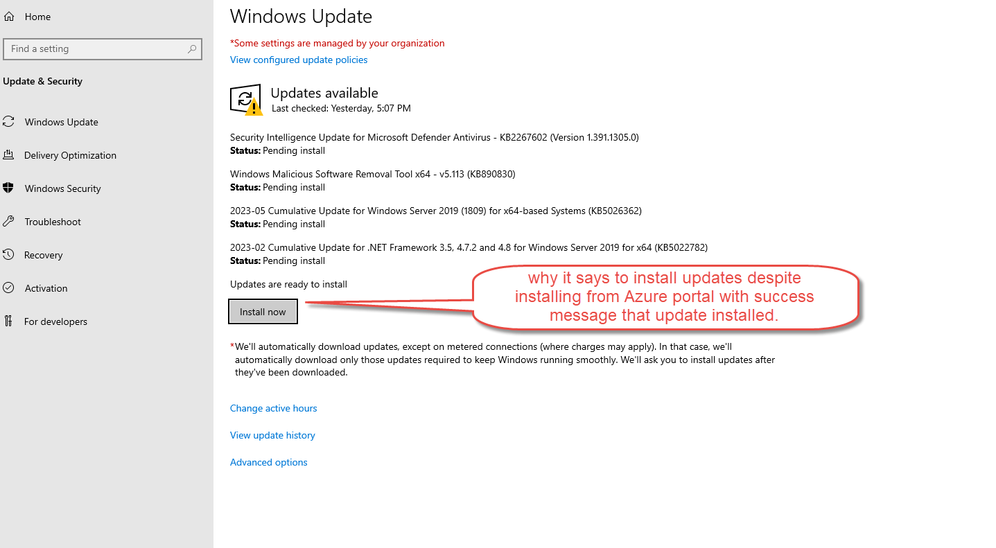

If I check from the view installed update from the control panel of the connected machine, I see no update installed. Moreover, while I see updates from the connected machine, I see update pending, Install.
Note: Server restarted multiple times after update installation from Azure portal.

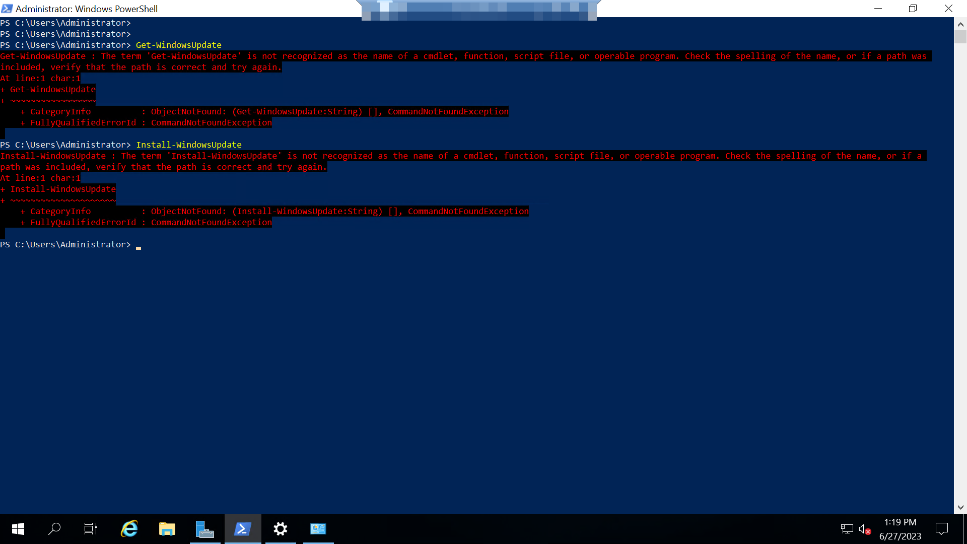

    If the issue persists, you can try running the following command in PowerShell on the connected machine to check for any pending updates:
    Get-WindowsUpdate
    This will show you a list of all the pending updates on the machine. You can then try installing the updates manually from the control panel or by running the following command in PowerShell:
    Install-WindowsUpdate
    If you are still unable to install the updates, you can try resetting the Windows Update components on the machine by running the following commands in PowerShell**1**:
    Stop-Service -Name wuauserv
    Stop-Service -Name cryptSvc
    Stop-Service -Name bits
    Stop-Service -Name msiserver
    Ren C:\Windows\SoftwareDistribution SoftwareDistribution.old
    Ren C:\Windows\System32\catroot2 catroot2.old
    Start-Service -Name wuauserv
    Start-Service -Name cryptSvc
    Start-Service -Name bits
    Start-Service -Name msiserver
    This will stop the Windows Update services, rename the SoftwareDistribution and catroot2 folders, and then restart the services. After running these commands, try checking for updates again and see if the issue is resolved.
