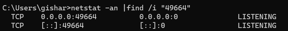

  2. msrini-MSFT 9,296 Reputation points Microsoft Employee
    2023-06-19T07:29:42+00:00
    Hi, Can you try to execute netstat -ano and check if the port which you wanted to connect is listening ? Then check your guest os firewall - Windows firewall or IP tables to see if that port is allowed or not.
