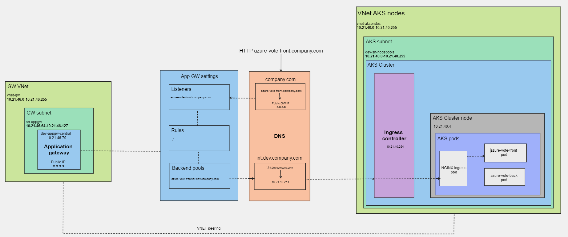

I am setting up a new environment in Azure for services running in AKS cluster. For the beginning and test I am using just one sample application - azure-vote-front.
The configuration is the following:
  • 2 VNETs have been set up,
    • for the application gateway (GW) - vnet-gw with address range 10.21.46.0-10.21.47.255
    • for the AKS cluster - vnet-aksondes with address range 10.21.40.0-10.21.40.255
    • the VNETs are peered
  • app GW was set up with public IP (private IP determined dynamically and set to 10.21.46.70)
  • AKS cluster was created and in it an Ingress controller installed at IP address 10.21.40.254
  • azure-vote-front app is deployed as ingress in AKS - the AKS node is running at IP 10.21.40.4 and the app also received 10.21.40.254 as External IP in Azure portal
    • the ingress has a rule in deployment YAML that defines "internal" host name used to determine the service to be invoked
  • company DNS zone has already been set up (e.g. company.com) with records pointing to existing services already in use
    • additionally added A record for the sample app - azure-vote-front.company.com pointing to public IP of the GW
    • this DNS zone is in a different Azure subscription than all the other resources created for this environment (although it doesn't seem important)
  • added new DNS subzone for my environment - int.dev.company.com
    • added A record to point all the traffic from this domain to the ingress controller - 10.21.40.254
  • app GW has listener at azure-vote-front.company.com with rule that targets the single backend pool pointing to FQDN azure-vote-front.int.dev.company.com
In theory, the idea of the setup is that when the request comes at azure-vote-front.company.com, the GW routes it to the ingress controller through the network peering, and the ingress controller further routes the traffic to azure-vote-front app in the cluster based on the "internal" FQDN (azure-vote-front.int.dev.company.com). The described setup is also shown on the diagram below.
