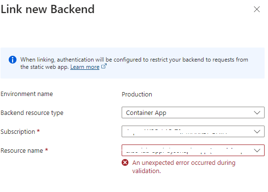

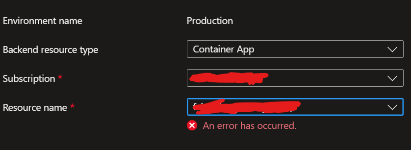

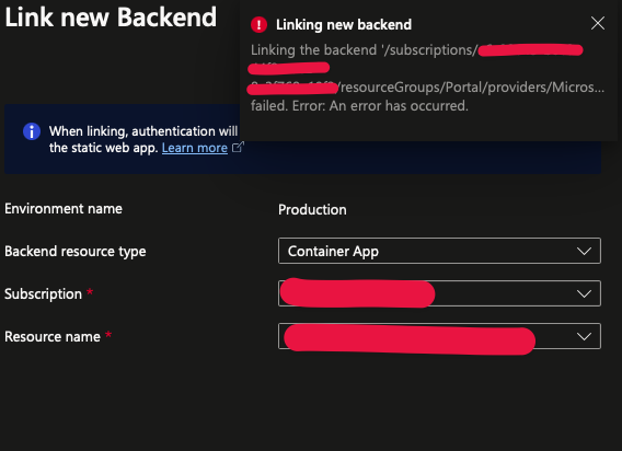

I am trying to link a Container App with enabled ingress and external access (perfectly reachable and requestable directly) as backend to a Static Web App (Standard plan). I always get "An error has occurred" with no further explanation.
I tried to do that in the Portal, with az cli, with REST API and with Pulumi. The result is always the same. The link cannot be created.
I tried to recreate the container app and its environment in different regions: West Europe, West US 2, Central US. No luck. I tried different names of the container app and its environment, with and without dashes. Nothing helps.
Enabled/disabled system-assigned managed identity for the Static Web App makes no difference either.
What can be the problem?

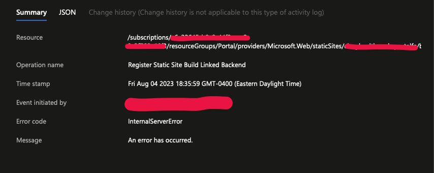

    Hello @Mikhail Smal ! , @Matt Brewer !
    I have spoken with the support Team and they recognized the issue
    It is fixed now for all supported regions
    Please check if yours is OK too!
    Thank you
