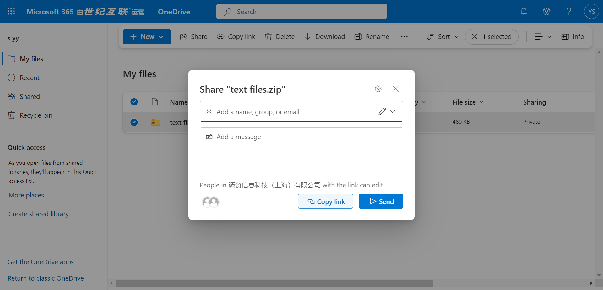

    then put unzipped text files up on OneDrive and share a link.

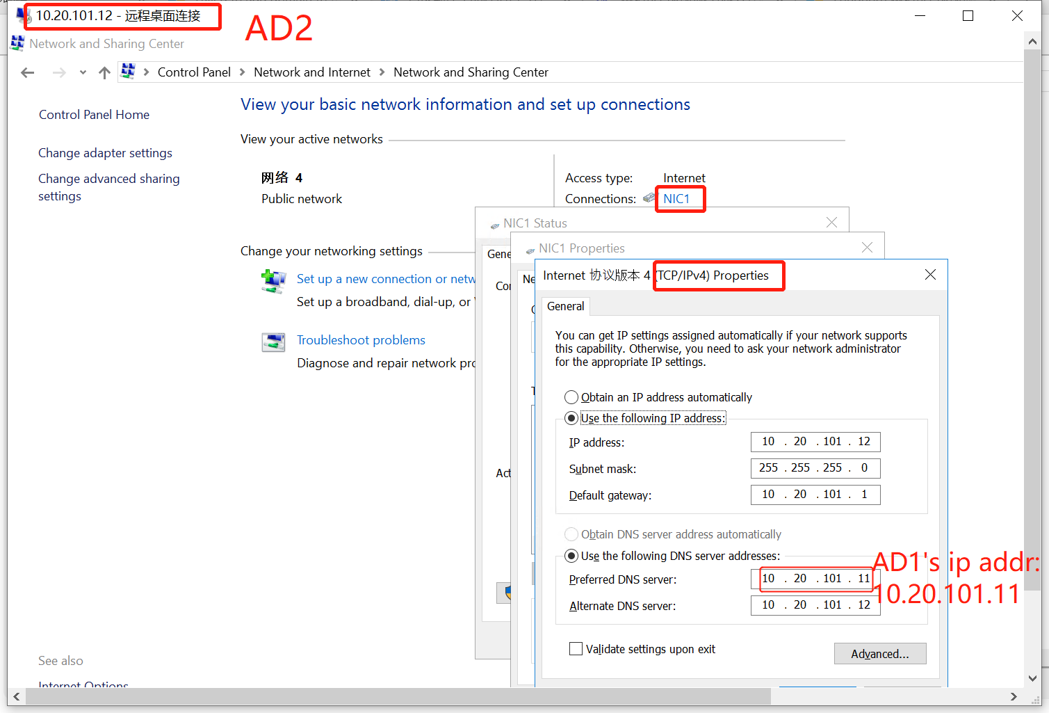

    2023-07-26T17:17:00.77+00:00
    These two domain controllers do not communicate on any level. I wonder how long this has been going on? Has the tombstone has been exceeded?
    no more endpoints available from the endpoint mapper

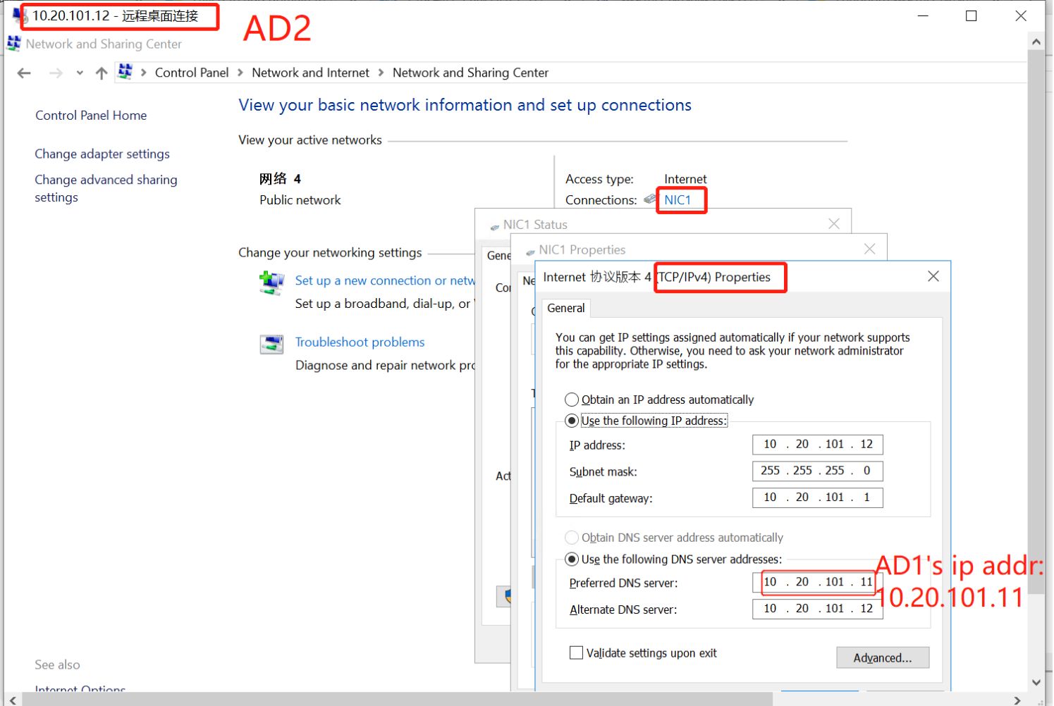

    replication appears to be blocked due to wrong firewall profiles other network issues.
    netstat -aon
    should show this result and a reboot may be needed to clear.

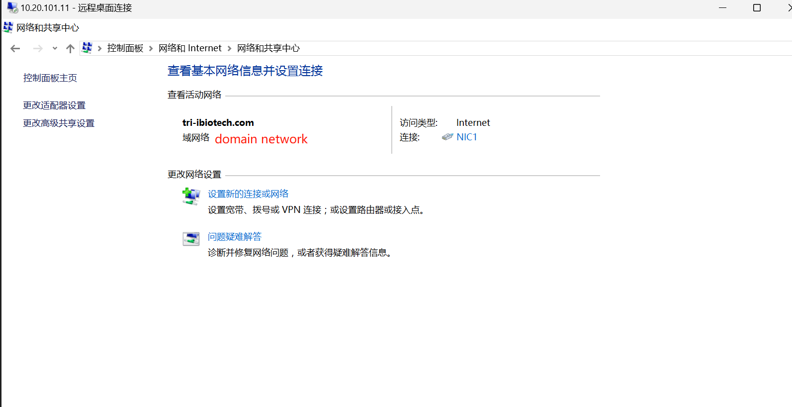

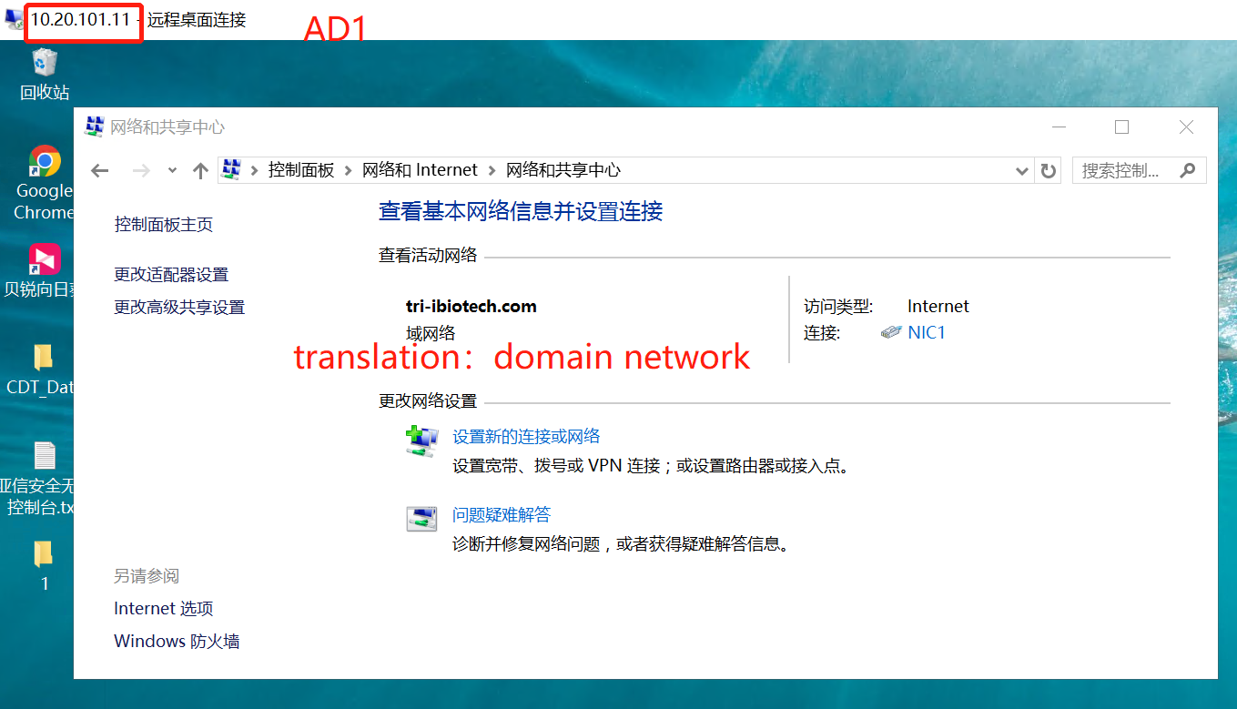

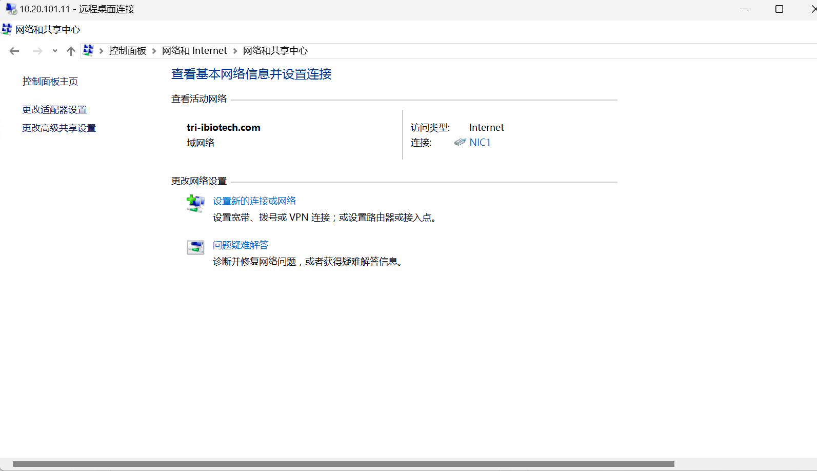

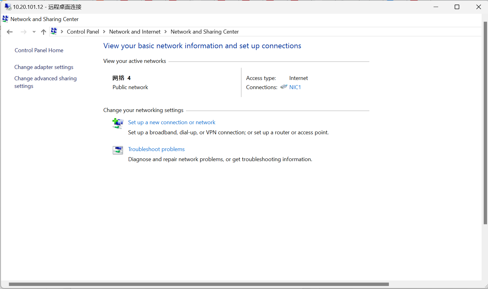

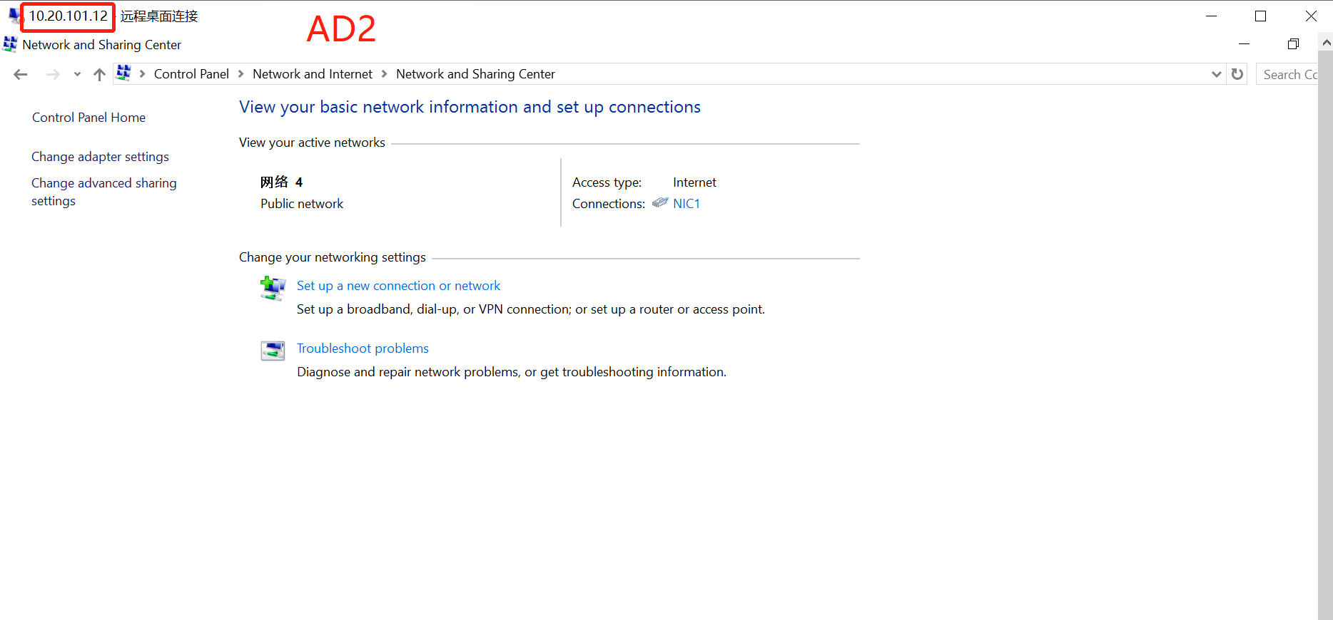

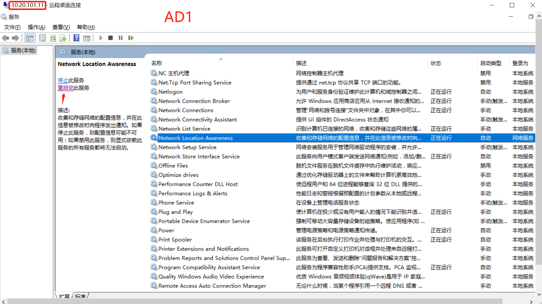

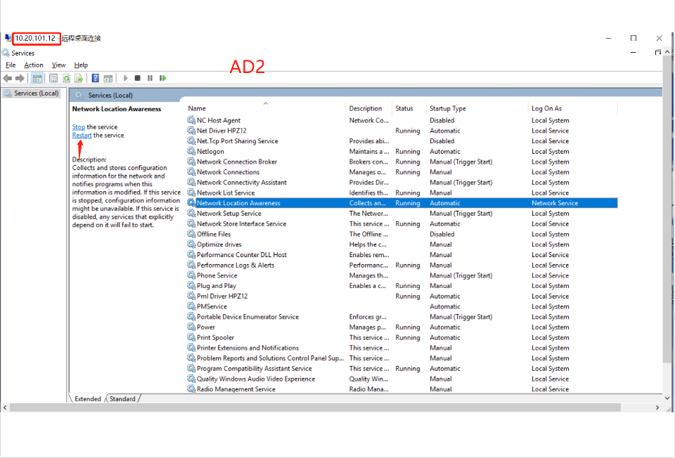

    I'd check that both got the domain network profile, possibly restart the Network Location Awareness service.
    2023-07-27T01:07:38.43+00:00
    I'd still check that both got the domain network profile, possibly restart the Network Location Awareness service. If you can get connectivity going then you could try a non-authoritative sync

    Sounds good, restarting them both at the same time could cause a race condition.
    When NLA starts to detect the network location, the machine will contact a domain controller via port 389. If this detection is successful, it will get the domain firewall profile (allowing for correct ports) and we cannot change the network location profile.
    If the domain was not found or process failed, NLA will let you to determine which firewall profile will be used, private or public, likely defaulting to Public
