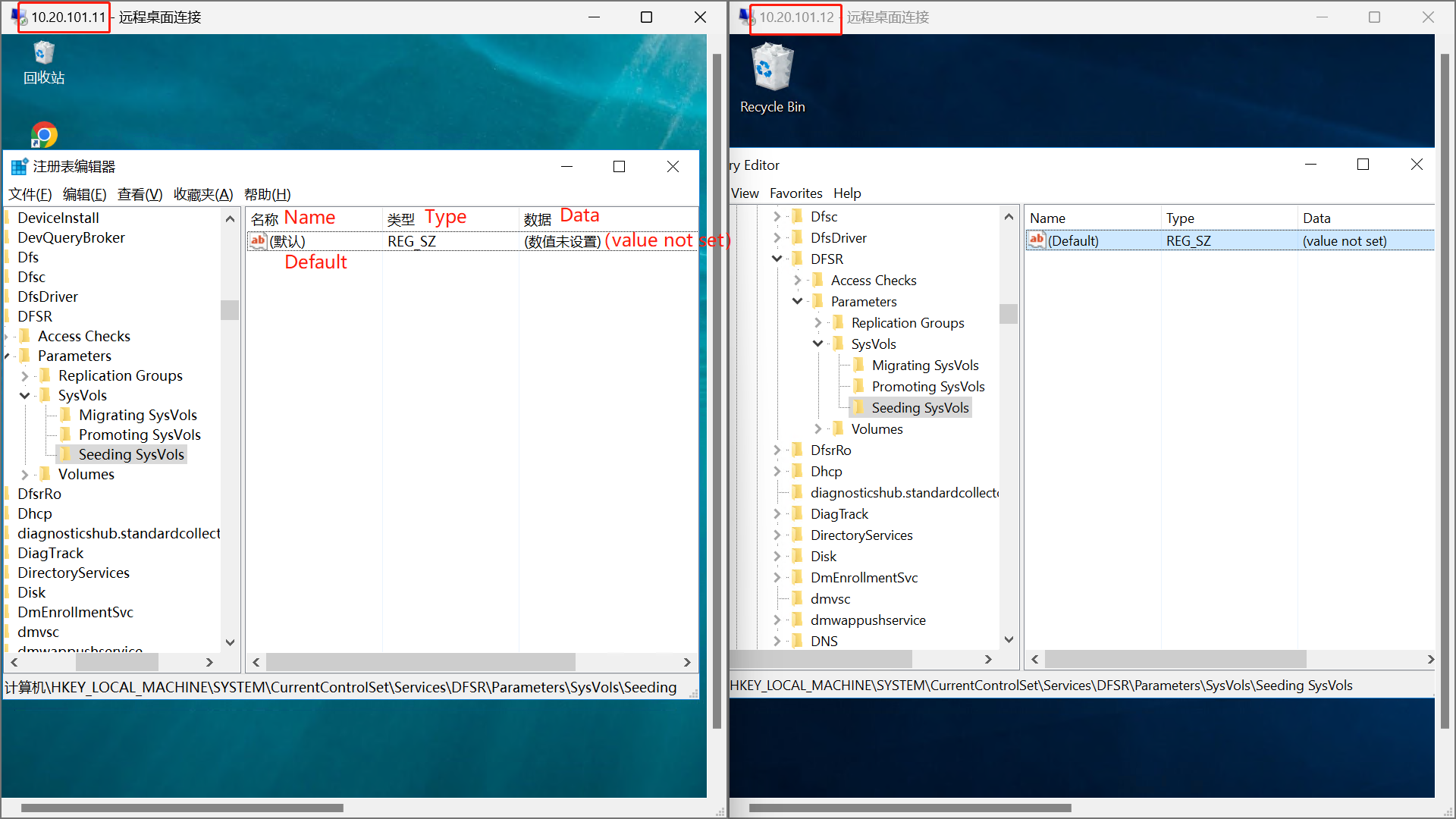

  1. The domain server has served as a master slave, with one master and one slave.
My client is currently unable to add domains, and every time I add domains, I report 'The target account name is incorrect'
Request guidance

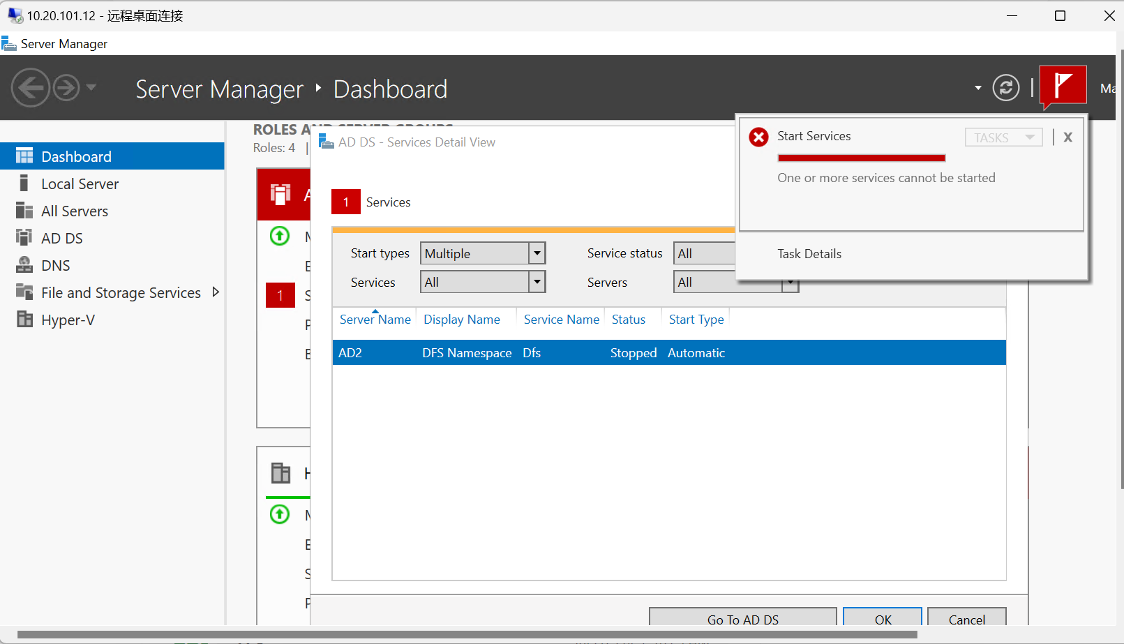

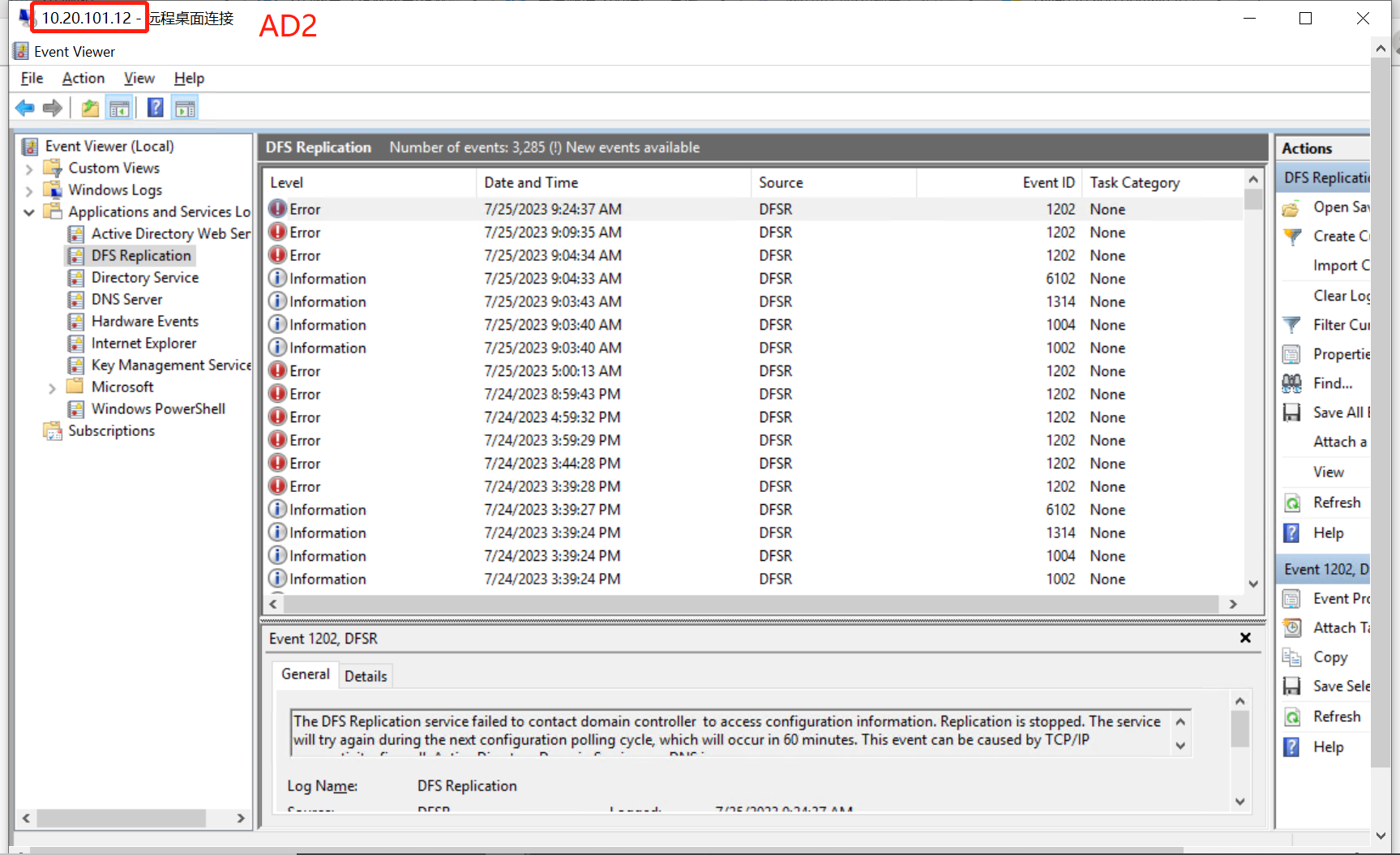

    I'd check the domain controller System and Replication (DFS or FRS) event logs for errors since last boot. Post the Event Source and Event IDs of any found. (no evtx files)
