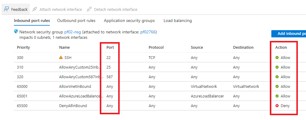

    The issue you are having can be due to the necessary ports are being blocked to accept the traffic you are looking for. Two ways you can check it
    1. Check the necessary outbound ports are opened as below
    1. Check the firewall status in the machine and see the firewall is blocking the required packets.
    sudo ufw status
    Status: active
    Above status shows that firewall is active in your virtual machine
    1. Disable the firewall and see if it allows the packets you are expected to see
    sudo ufw disable
