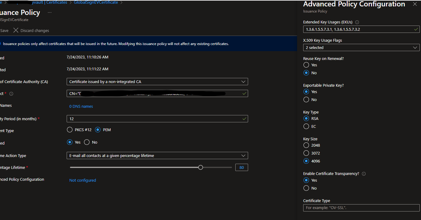

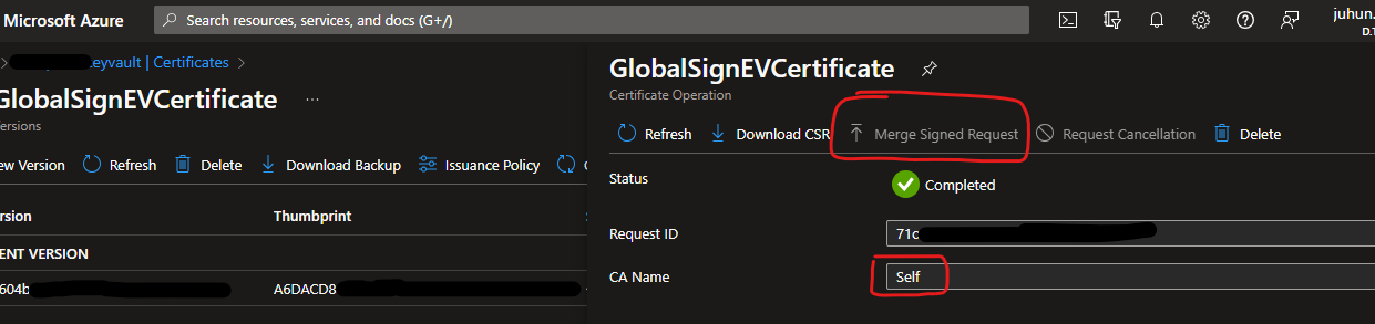

Hello,
I am trying to create a certificate on Azure Keyvault with EV Code Sign Cert from GlobalSign.
I followed the steps but the "Merge Signed Request" button is not clickable at all.
GlobalSign support couldn't figure out why this is happening. Any suggestions/ideas to this issue?
Thank you!

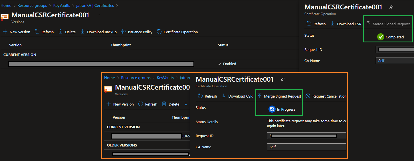

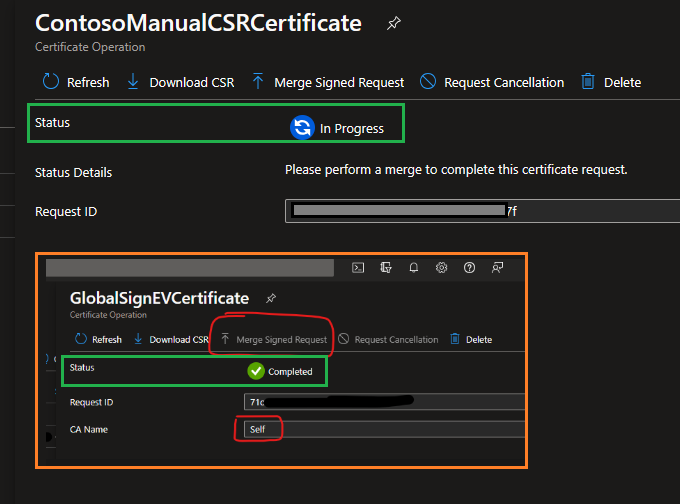

    When it comes to adding certificates in Key Vault issued by non-partnered CAs - I reproduced your issue and noticed that once my certificate is created, it's "enabled" and shows "Completed" when I navigate to the Certificate Operations pane, additionally the "Merge Signed Request" button is greyed out.

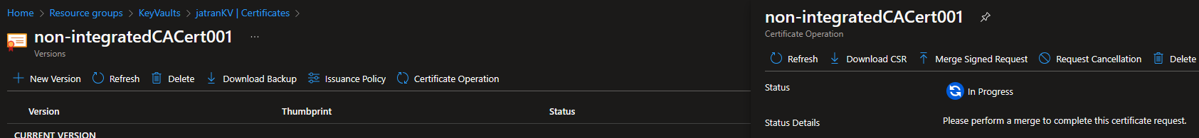

    Looking at one of my older non-partnered CAs that I created, it looks like everything is working as expected with the Status showing "In Progress".
    • Because this looks like a potential bug, I've reached out to the Key Vault team regarding this and will update as soon as possible.
