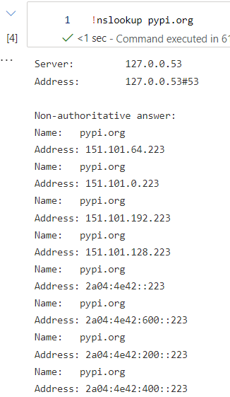

    As the question is tagged with Azure firewall, I am assuming you have configured applications rules to allow FQDN's pypi.python.org,pypi.org,pythonhosted.org,files.pythonhosted.org with protocols Http:80,Https:443,Https:3128 but you are still unable to install any pip components and unable to reach pypi.org
    Based on my understanding above, you can try below mentioned troubleshooting steps and see if you are able to resolve the issue.
    • As you are unable to reach pypi.org, this can be a DNS issue. To validate you can run the command nslookup pypi.org and see if it is resolving an IP address. If there is no output received, you can check if you need to configure a Network rule on your firewall to allow communication via port 53(DNS). You can follow the example here.

  2. Raghul Kannan 191 Reputation points
    2023-07-26T04:05:52.2266667+00:00
    The issue was I had created synapse workspace with Data Exfiltration enabled, I re-created with it being disabled and everything is working as expected now
