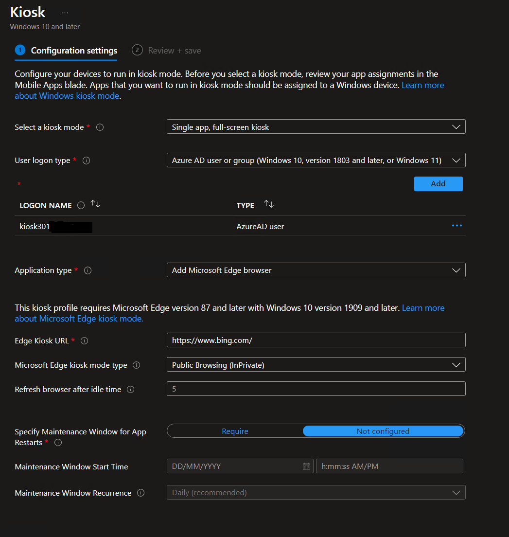

  2. Crystal-MSFT 53,986 Reputation points Microsoft External Staff
    2023-07-27T01:27:33.7533333+00:00
    @Jamal Talibi, Thanks for posting in Q&A.
    For the first error, it seems the account you set in the xml is unable to find its SID. Please check which account you set and see if it is in your environment. For the second error, as this is not English, I translate it and it seems the issue is with ./Device/Vendor/MSFT/Policy/Config/Bluetooth/SetMinimumEncryptionKeySize. Please check if the value you set is between 1 to 16.
    https://learn.microsoft.com/en-us/windows/client-management/mdm/policy-csp-bluetooth#setminimumencryptionkeysize
    Please check the above information and if there's any update, feel free to let us know.
  3. Jamal Talibi 0 Reputation points
    2023-07-27T12:21:16.07+00:00
  4. Jamal Talibi 0 Reputation points
    2023-07-28T07:23:36.2733333+00:00
    @Crystal-MSFT Thanks for the reply, Please find attached the kiosk configuration profile Sans titre.png
