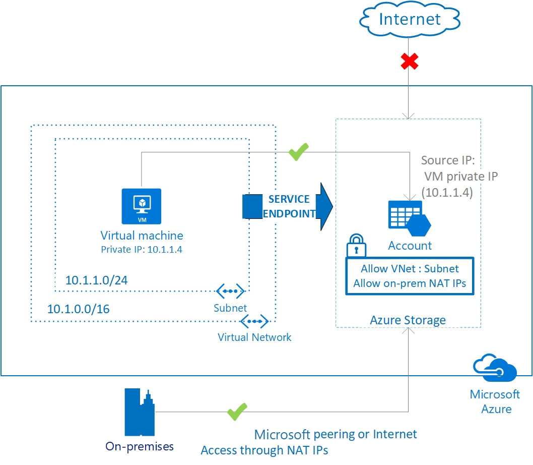

    Service Endpoints
    They are already using this, but like I was trying to explain in the initial post, the problem does not lie in how the services are able to connect. The problem lies in the lack of any way to deny all other network access.

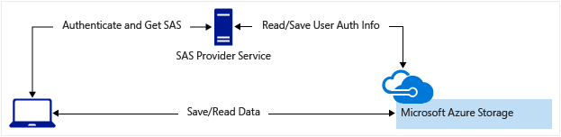

    Use SAS Tokens
    We are using SAS tokens for Fivetran at-least, but this doesn't address the problem of locking down the storage account itself does it? Are we able to disable public access to a storage account while using SAS Tokens? It's my understanding that this would not work, in every experiment I've tried this results in no connectivity.
    This concern could be fixed in multiple ways, but none of those ways are available to the user as far as I can tell.

    Service Endpoints

    Use SAS Tokens
