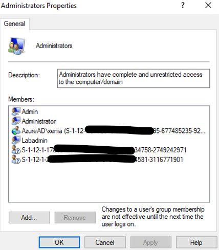

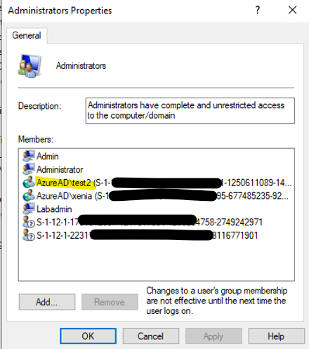

    In my test, I want to remove "AzureAD\test2" in the administrator group and I deploy this profile to my device group. Here is my configuration:
    After this profile shows successful deployment, I restart the target device and the I find that "AzureAD\test2" is removed successfully.
