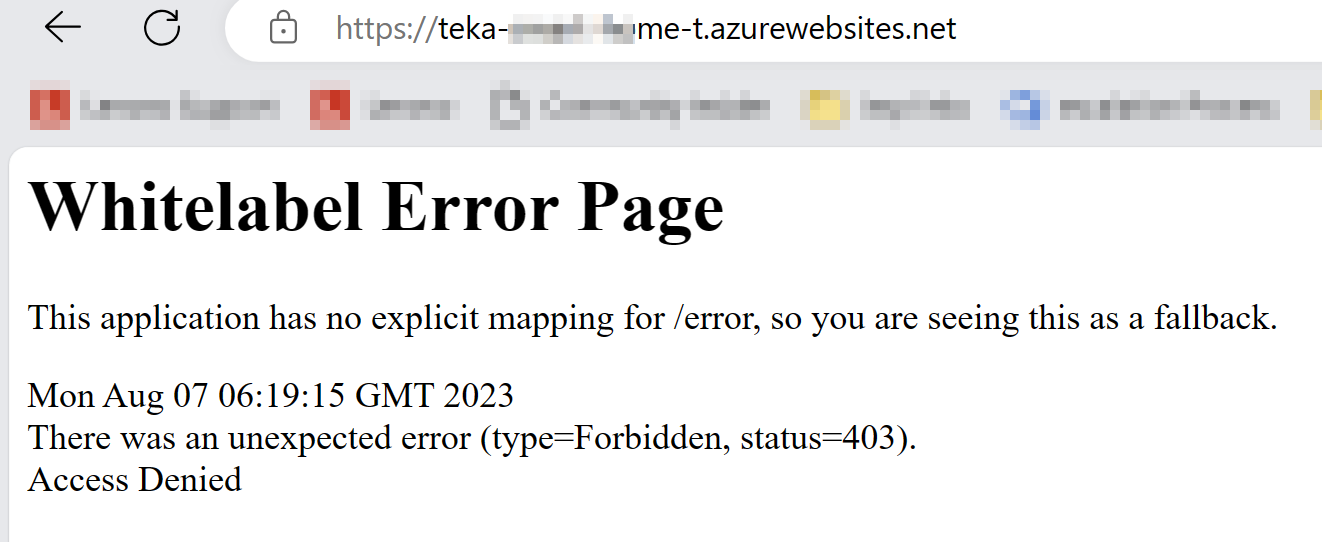

    Issue: Web app running Docker container (Java 8, spring framework 2.2.5) suddenly won´t start.
    Resolution:  Instances change required. This was possible by scale up and down of the app service plan which forced a change of the instances bringing up the webapp to running state.
