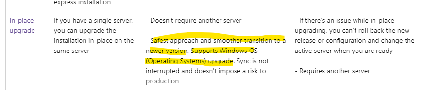

    I would note that in place upgrades of the Windows O/S are supported with AADConnect:
    https://learn.microsoft.com/en-us/azure/active-directory/hybrid/connect/how-to-upgrade-previous-version
