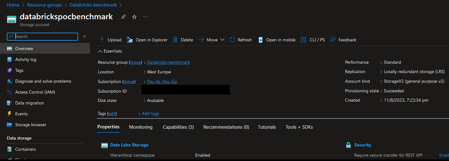

We are trying to implment Azure data bricks for our Proof of concept work, which involves the following.
  • Gen 2 storage account with Hierarchical namespace enabled.
  • Azure data bricks connector with the "Storage blob data contributor" permission assigned to it as shown in the image below.
permission
We have populated the details with the correct format for ADLS gen2 path and Azure connector ID :
enter image description here
But when We are try to create an Azure metastore, we get the following error (Access validation failed - Internal server error).
Error
Note : all of our resources (Resource group, storage account, Azure data bricks connector which is used as system managed identity) are in the same same region (West-Europe).
We also tried creating it in a different regions according to the supported regions documentation (https://learn.microsoft.com/en-us/azure/databricks/resources/supported-regions) but the same issue persists.
Any suggestions / valuable feedback to fix this issue is appreciated!
