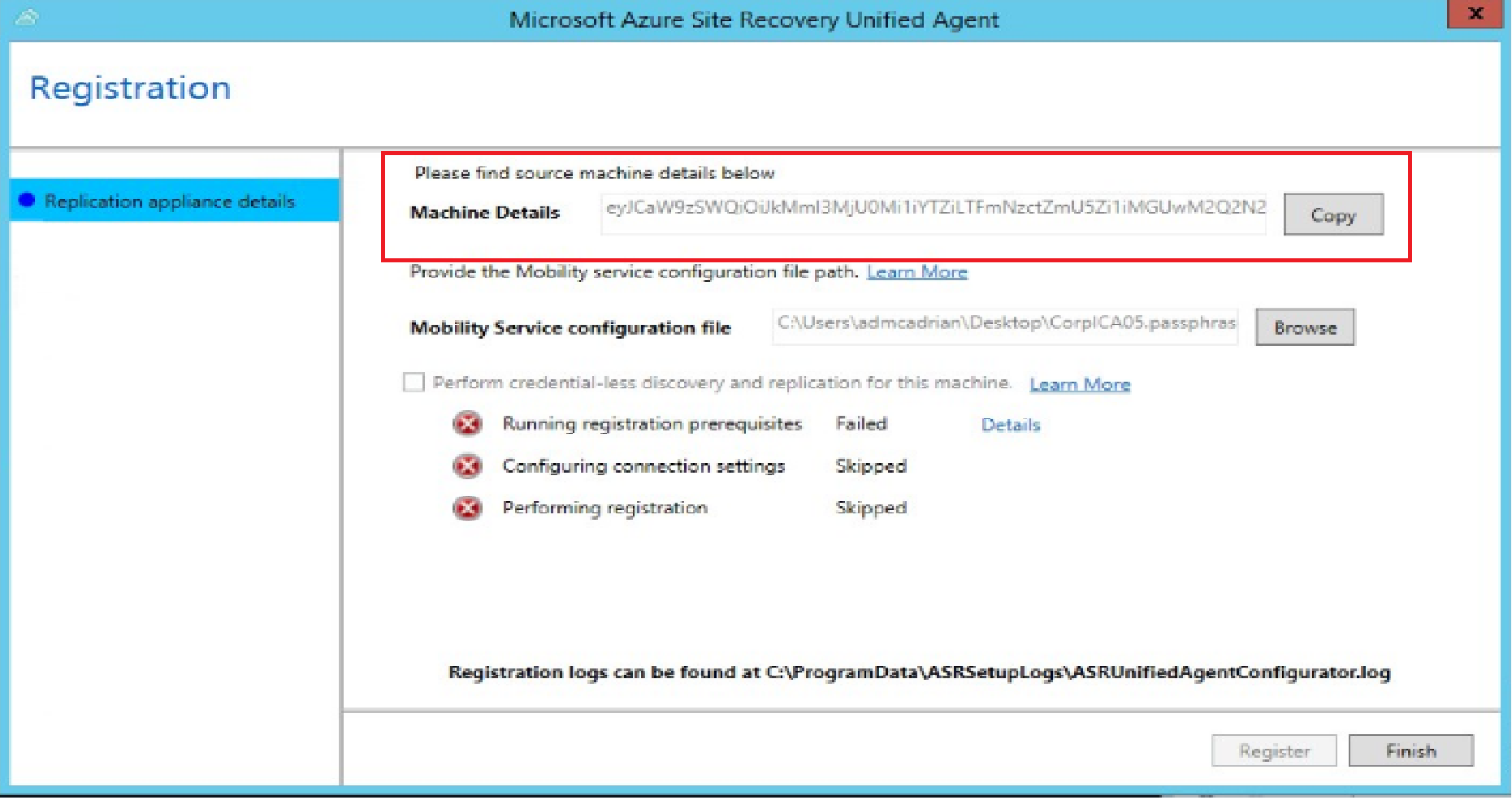

Hello,
I am trying to migrate some physical servers into Azure but I am not having any luck during the Mobility service installation.
I have prepared and installed the configuration server, it is registered in the Azure Migration project and based on this document I have to install an agent on each physical machine I want to migrate.

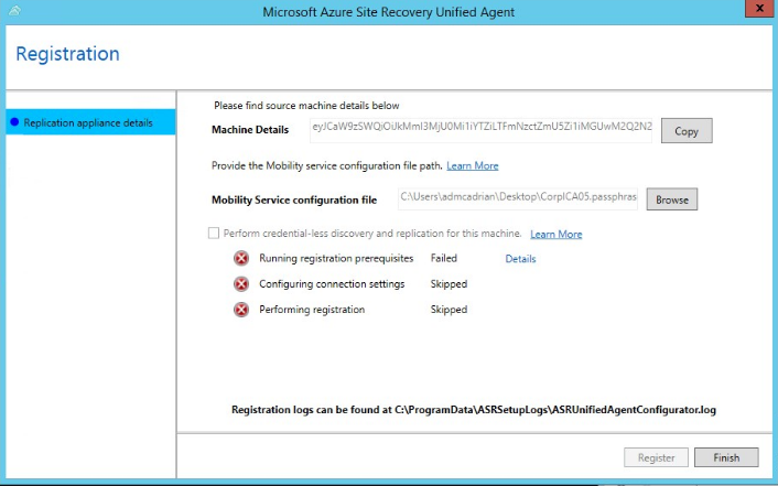

I have installed the agent on a physical machine, but I am having issues finding/generating the Mobility service configuration file and it does not let me move forward without this.
2023-08-16_17-16-21

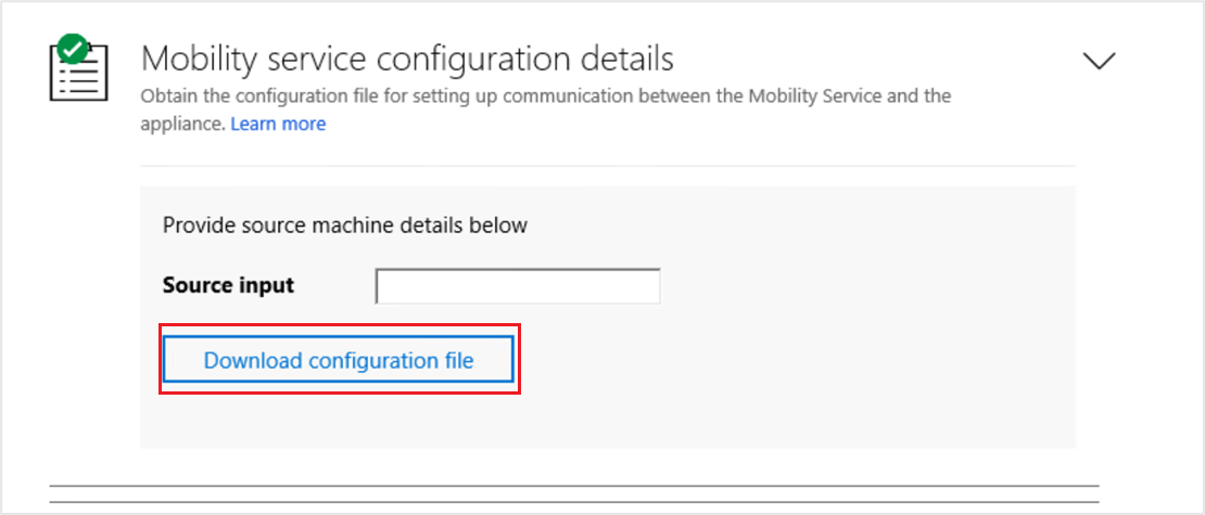

Based on another article I am supposed to generate this from the Management appliance, the one that does the discovery, but I cannot find the option here also.
Bear in mind that everything is in private mode, not public.
Can anyone put a light on this so I can pass this wizard screen and move on?
Thanks in advance,
Adrian

  1. Prrudram-MSFT 28,486 Reputation points Microsoft Employee Moderator
    2023-08-17T14:25:29.9866667+00:00
    Hi @AdrianC
    You can obtain the passphrase from the replication appliance. From the configuration server(Appliance) launch a windows command prompt and run below
    C:\ProgramData\ASR\home\svsystems\bin\genpassphrase.exe -v to view the current passphrase.
    Don't regenerate the passphrase. This will break connectivity and you will have to reregister the replication appliance.
    and then proceed to register mobility agent with configuration server.
    If the deployed appliance is ASR modern appliance, you can see details i provided for obtaining the passphrase on a similar thread here https://learn.microsoft.com/en-us/answers/questions/1183528/azure-site-recovery-(modernized-vmware)-configurat
    If the issue still exists, It is important to investigate the logs to know the exact cause of the issue. In that case please share the registration logs C:\ProgramData\ASRSetupLogs\ASRUnifiedAgentConfigurator.log to link to this thread to AzCommunity@microsoft.com with subject line as "ATTN: Priyanka".
    Also, you can notify me by commenting on this thread.
    If this does answer your question, please accept it as the answer as a token of appreciation.
