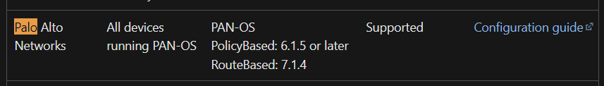

    First, please make sure the OnPrem device is validated:
    You can also download the OnPrem Device Configuration file from the VPN Gateway
