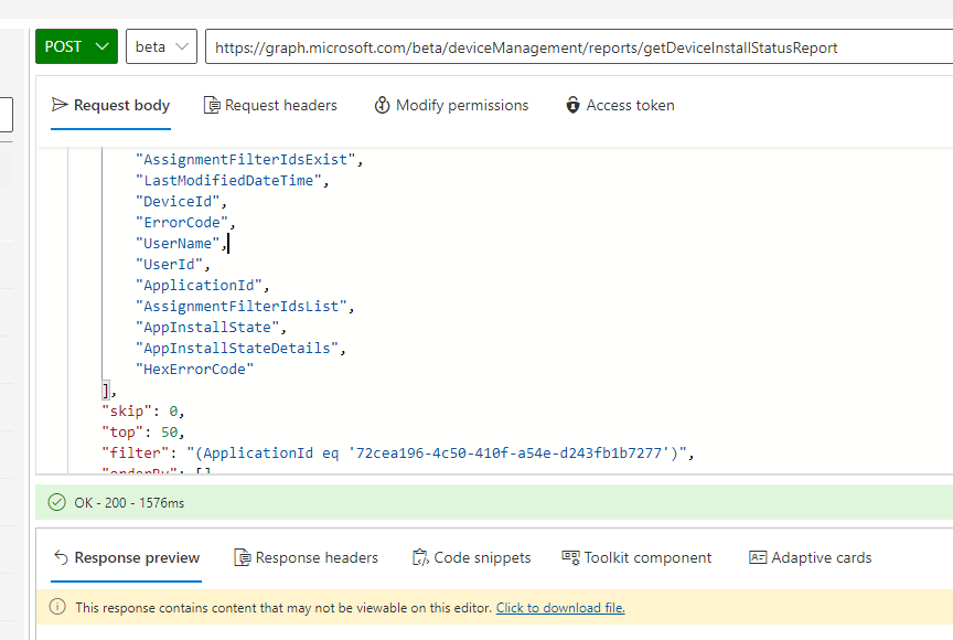

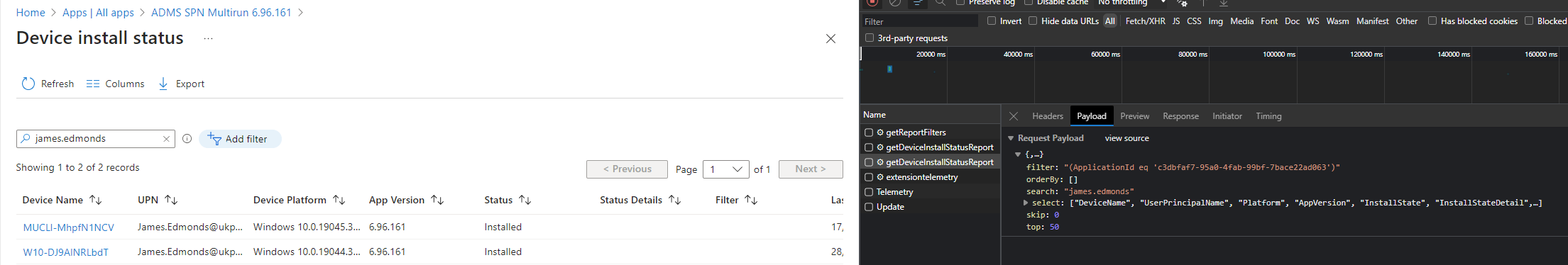

    @JamesEdmondsUKPN, Thanks for posting in Q&A. Based on my log capturing from Edge DevTool, I find the following method to get the device install status for one specific win32 app.
    And when using Graph explorer to get the information, we can try the following:
    Action: POST
    Version: Beta
    URL:https://graph.microsoft.com/beta/deviceManagement/reports/getDeviceInstallStatusReport
    Request Body:
        "select": [
            "DeviceName",
            "UserPrincipalName",
            "Platform",
            "AppVersion",
            "InstallState",
            "InstallStateDetail",
            "AssignmentFilterIdsExist",
            "LastModifiedDateTime",
            "DeviceId",
            "ErrorCode",
            "UserName",
            "UserId",
            "ApplicationId",
            "AssignmentFilterIdsList",
            "AppInstallState",
            "AppInstallStateDetails",
            "HexErrorCode"
        "skip": 0,
        "top": 50,
        "filter": "(ApplicationId eq '<your app id>')",
        "orderBy": []
    Hope the above information can help.

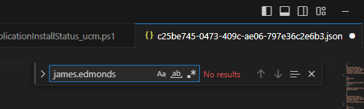

    I get some data back, but am struggling to handle it.
    I find that I am unable to directly call the .Values property of the resulting PSObject, as per my SO post here:
    https://stackoverflow.com/questions/77473264/how-does-invoke-restmethod-parse-a-json-response-into-a-ps-object
    I am also curious, as the data is contained within the Values property, it has not field names of column headings in it. That is all stored in another property called Schema.
    How can I take the column headings from the Schema property, and associate them with the arrays of values in the Values property?
