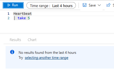

    1. Note that the tables in LA workspace are only visible if they have some data in it. Therefore, sometimes even the most common tables (like heartbeat) are invisible if there are no data in it. However, this does not mean that the query would fail (as posted in the question above). It simply means that the query would return something as below:
