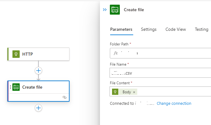

I am trying to retrieve data using URL on a daily basis (data gets populated in a csv file).
(I figured Azure Logic App would do it, but I am not sure Azure Data Factory is a necessary tool.)

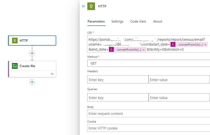

Basically, I have a URL with two date parameter that if I just run the URL in the browser, the output is in a csv file.
As you can see on the bottom, there are two areas with date ranges (possibly using some type of expression for those two parameters).
If I just change the date range, I would get the different data, with the final result in a csv file.
https://portal.test.com/care_ctr/reports/report/census/email?uname=******@fakecompany.com&start_date=2023-09-05&end_date=2023-09-05&facility=0&division=0
If I use Azure Logic App, which object should I use?

  1. Pramod Valavala 20,656 Reputation points Microsoft Employee Moderator
    2023-09-22T16:26:24.01+00:00
    @Justin Doh Apologies for the delay here! Glad you were able to solve till creating a file with the content.
    If you are looking to download files and don't specifically need Azure File Storage, it would be better to create a file in Blob Storage instead using the Azure Blob Storage Connector instead.
    With this, you can use the Create SAS URI by path (V2) action to generate a URL that can be used to download the file. You could extend the workflow to send this URL in an email, teams message, or into an excel sheet for example.
