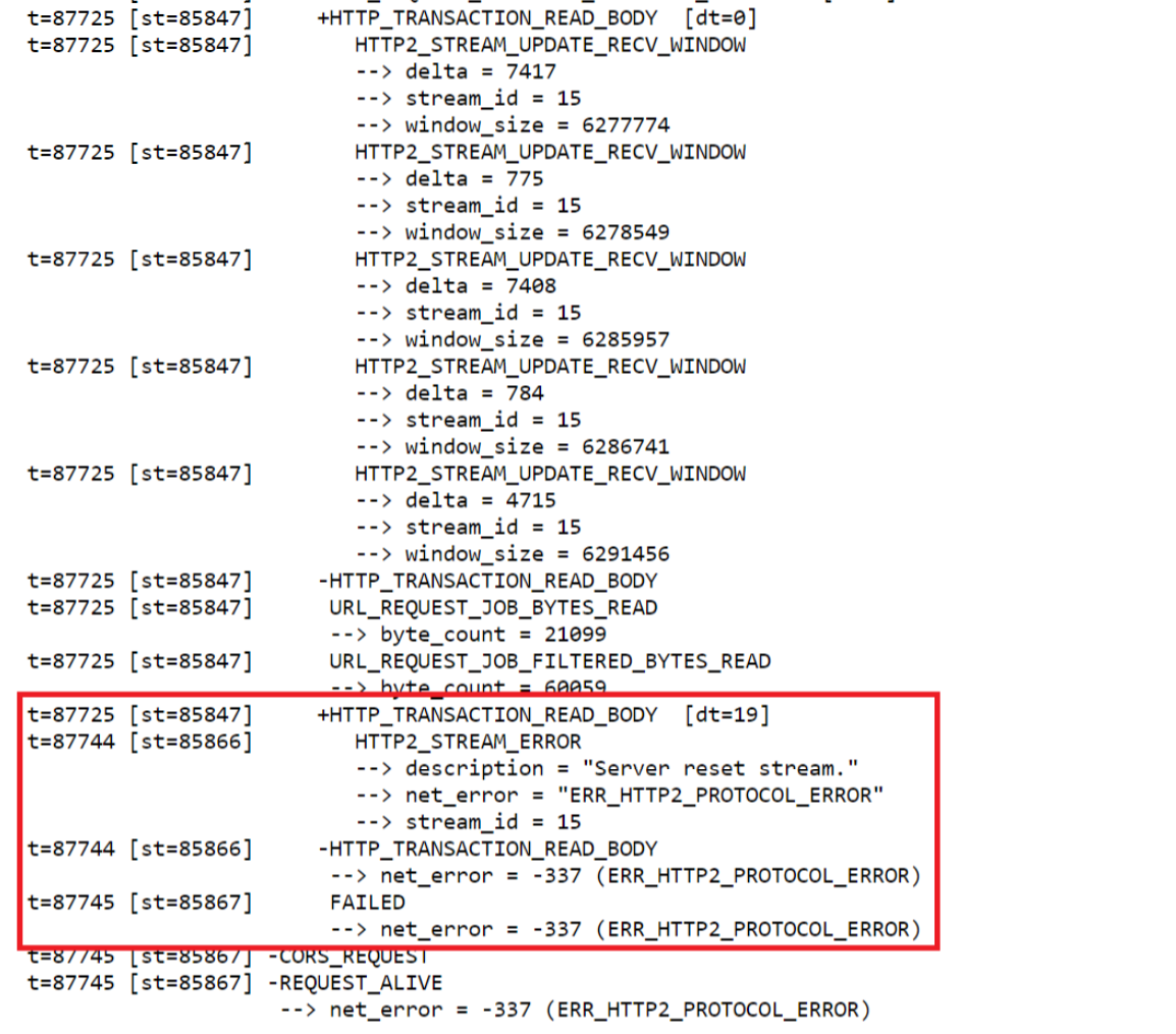

The origin points to an Azure App Service running NodeJs and Angular. It works for images and static assets but js and css files times out. It seems like they are partially read and then the stream fails?
Here is a logging of the error:

    I understand that you have an azure app service and an Azure CDN in front of it and when trying to load the next assets like js and css files, you receive an ERR_HTTP2_PROTOCOL_ERROR.

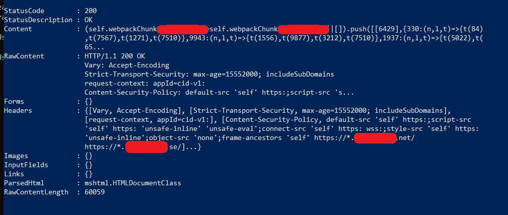

    You did a CURL to the origin and received 200 OK, but the results didn't have the details I needed, so requested you to do a CURL again using the below command and reshare the results:
    curl.exe -v -o nul --range "0-8000000" -H "Accept-Encoding: gzip" "https://abcdomain.azureedge.net/assets/index.js"
