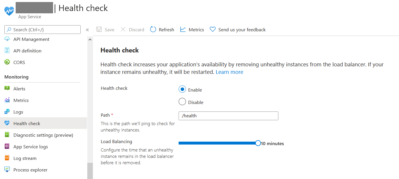

    In order to enable the health check of an app service instances from the Azure Portal.
    Please find steps below,
    App Service -> Monitoring -> Health Service and you have to provide a health probe path URL. This url has to specify to which endpoint you are trying to ping.
    Then it will ping to that specific endpoint at regular intervals.
    If the URL returns an error HTTP status code or fails to respond, the instance is identified as unhealthy and removed from the Load Balancer rotation.
    If you are looking for detailed explanation please follow the blog given below.
    https://dotnetthoughts.net/azure-app-service-enable-health-check/
    If an instance remains unhealthy for one hour, it will be replaced with a new instance.
    Enable Health Check in Azure App Service
    You can also verify health check by going to Metrics page from the health check blade. This will redirect to the health status page and provide the ability to add a new alert rule too.
