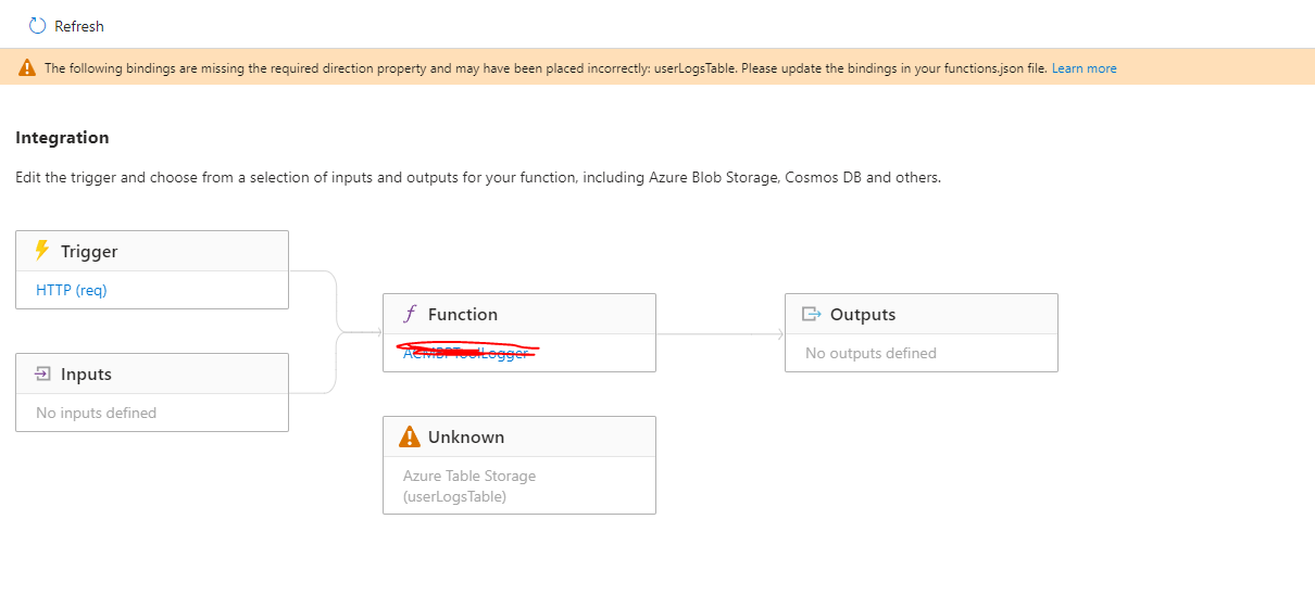

I created a Azure functions (HTTP Trigger) v4 that writes data to an Azure Table storage.

I can test this locally using Azure Storage emulator (connecting via localhost) and can see the table "tablename" being populated with data as its being written to it. I then deployed this Azure function and set it as managed identity and gave it Table Storage contributor to my table. Everything was successful. I trigger the function from my local app and can see in the monitor its being triggered. I look at the logs and can see everything is OK, no errors. 2023-09-14T16:21:13Z [Information] Executing 'xxx' (Reason='This function was programmatically called via the host APIs.', Id=1f419d7c-67b4-4df1-b9d1-fda6a67acc5f) 2023-09-14T16:21:13Z [Information] C# HTTP trigger function processed a request. 2023-09-14T16:21:13Z [Information] Log entry added successfully. However, when checking the table, its unchanged and still empty. I dont know if its an access issue, or an issue with my function code. I am getting the "Log Entry added successfully" print statement which leads me to believe there were no errors. How do I debug the issue? I am not sure where to start looking.

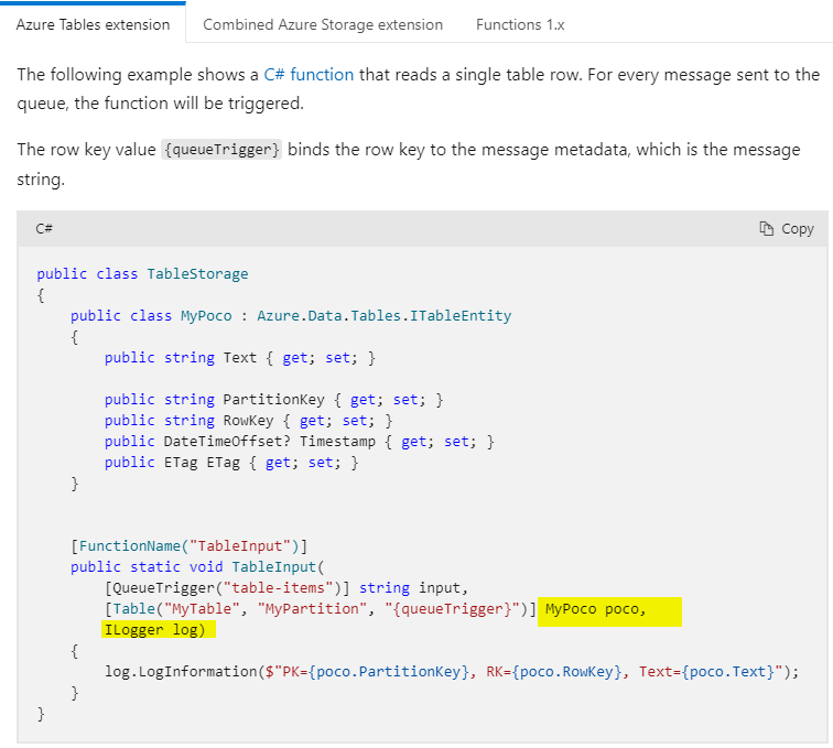

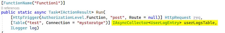

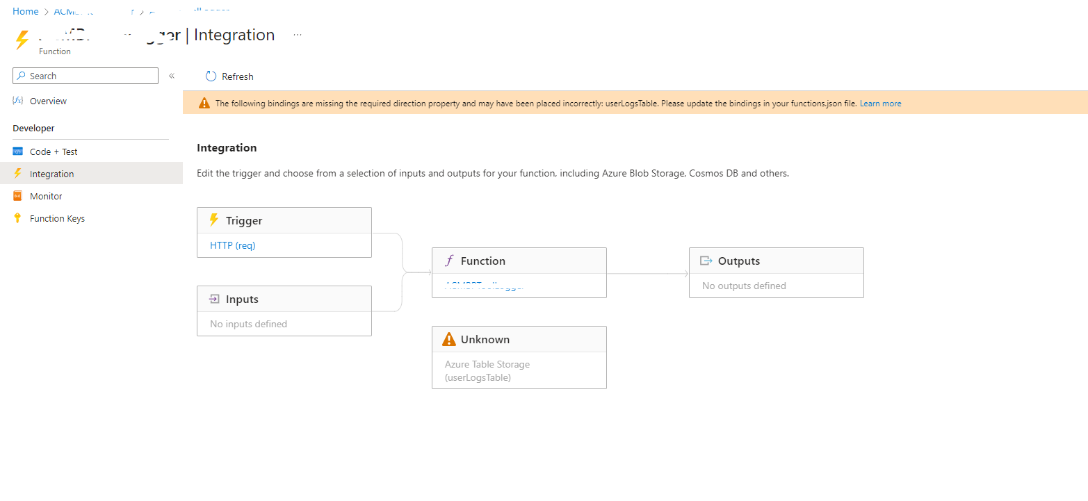

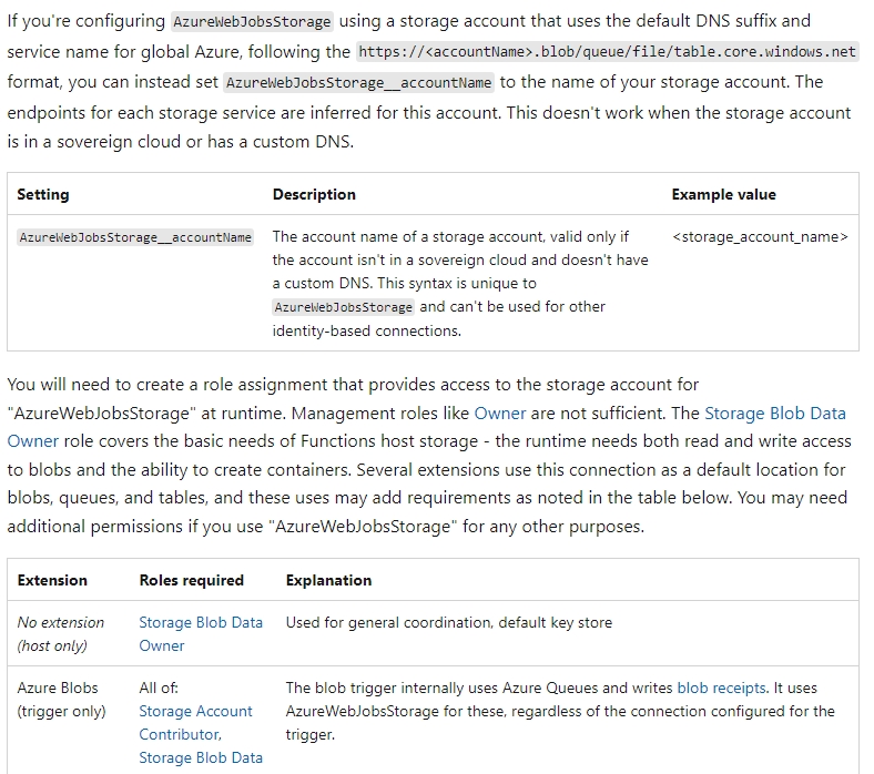

    Sorry for the delay. you can certainly use identity:
    https://learn.microsoft.com/en-us/azure/azure-functions/functions-reference?tabs=blob&pivots=programming-language-csharp#connecting-to-host-storage-with-an-identity&WT.mc_id=AZ-MVP-5005174

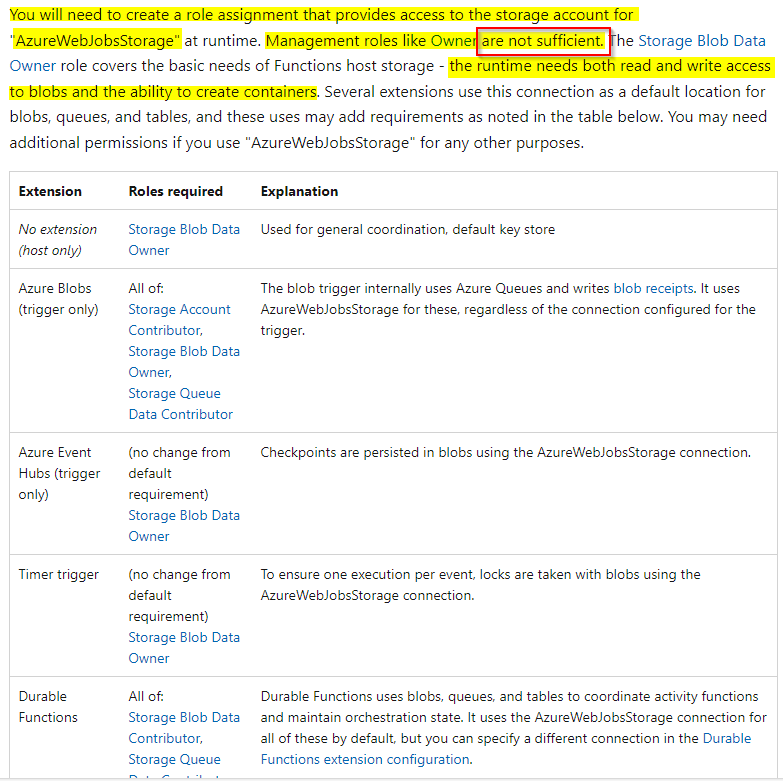

    I just wanted first to see if the code was working with a connection string to rule out code problems. Did you only assign a role with access to the table? AzureWebJobsStorage is used by the function app to store function app related data, so, it's more complicated.

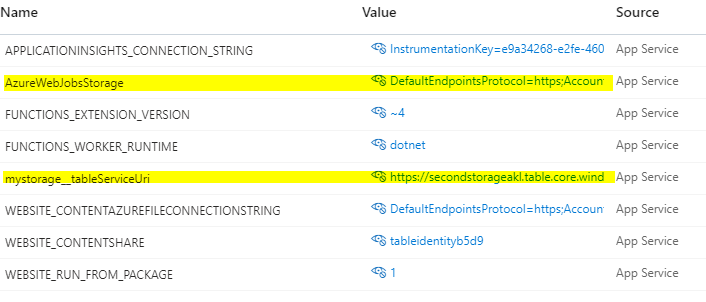

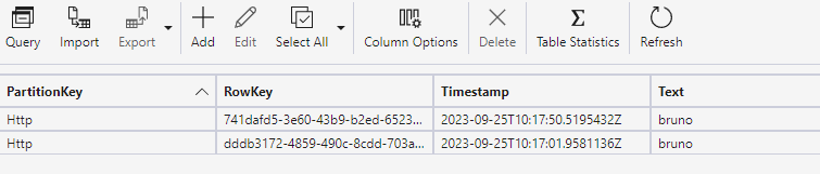

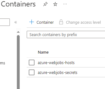

    If I try this using "AzureWebJobsStorage" and only Table Storage contributor role it does not work. The function needs more access:

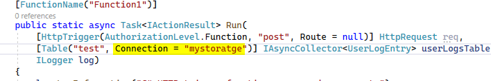

    example of function app data controlled by AzureWebJobsStorage:
    if I use a different storage from the one used by AzureWebJobsStorage, than roles for the table only work fine. Look like you can use the same storage but you will need to add more roles
