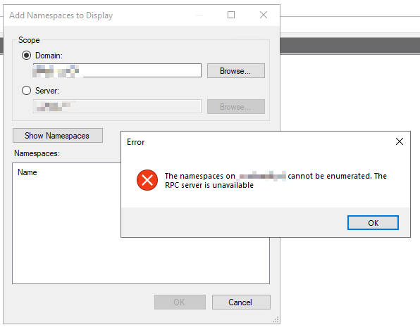

Since namespace of DFS file server have problem - The namespaces on myoffice.com cannot be enumerated. The RPC server is unavailable.
