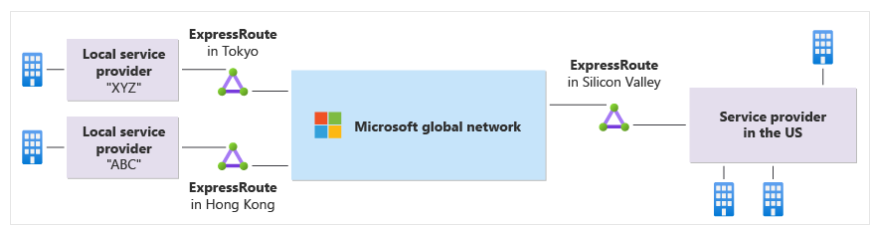

    Also, if you want to connect your DC networks via the ExpressRoute service, then you've to enable Global Reach.
    ExpressRoute Global Reach is a connection between 2 ExpressRoute circuits and your cross data-center traffic traverses through Microsoft's network backbone from one Microsoft edge router to the other Microsoft edge router. This traffic will not traverse through the ExpressRoute gateway or the Vnet, so network filtering through Azure Firewall on the Vnet will not be possible.
