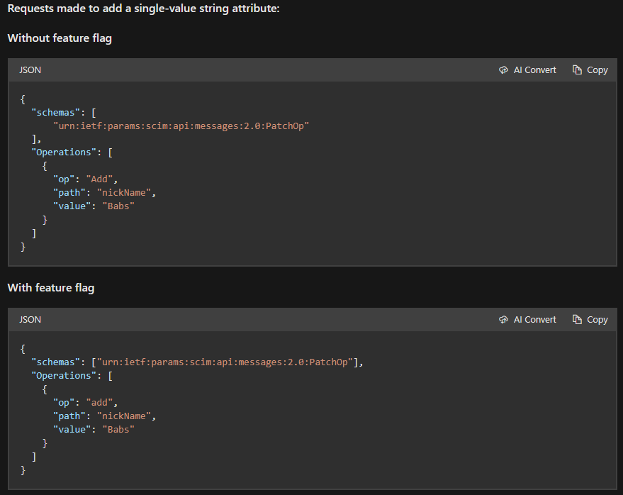

    Based off your error and from @Danny Zollner 's comment it looks like there's an issue with the JSON payload that you are sending to Azure AD.
    • Have you confirmed that the JSON payload is formatted correctly?
    • Are any additional error messages within the Azure AD provisioning logs?
    When it comes to the patch request from Azure AD containing the "Op" with an upper leading character, can you share what you're seeing? From the Known issues and resolutions with SCIM 2.0 documentation it looks like there are flags (With / Without feature flag) you can alter that won't cause issues with lower- or upper-case characters.
    • If you're still having issues and would like to work closer with our support team on this, please let me know. I'd be happy to enable a one-time free technical support request for your subscription so you can work with our support engineers to get this issue resolved.
