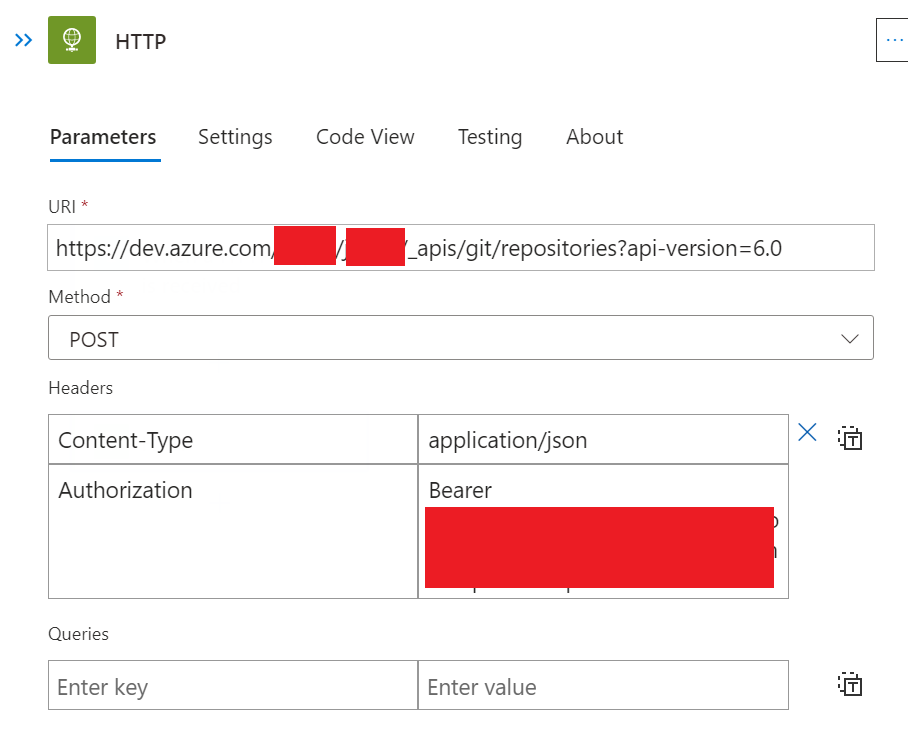

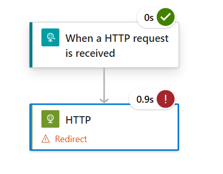

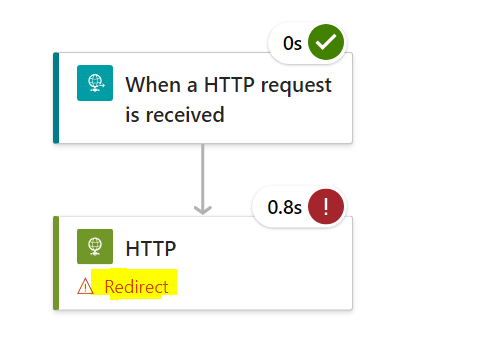

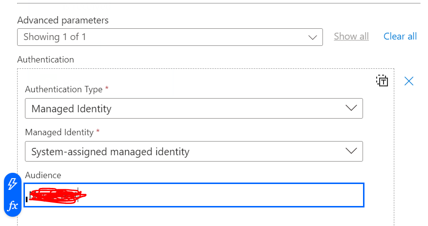

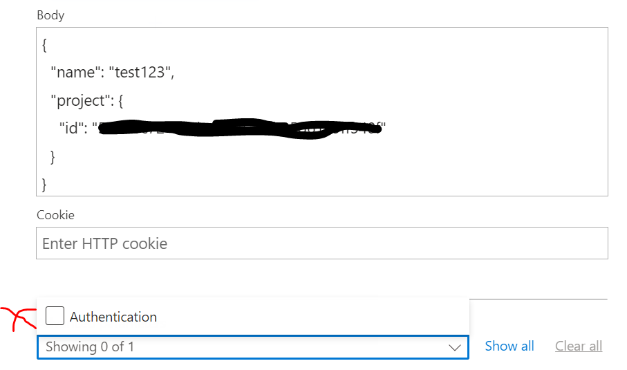

Im trying to create repository in Azure DevOps with HTTP action in Logic App with following steps, but I'm getting "Redirect" error in that step. Please check & guide someone to resolve this. Instead HTTP i also tested with "Send HTTPS request to DevOps" that time getting below error. Please help.
"TF400813: The user 'aaaaaaaa-aaaa-aaaa-aaaa-aaaaaaaaaaaa' is not authorized to access this resource.\r\nAzure DevOps ActivityId: defa4b32-2d1f-4a98-ab6d-a724e20b1a63\r\nDetails: {\"$id\":\"1\",\"innerException\":null,\"message\":\"TF400813: The user 'aaaaaaaa-aaaa-aaaa-aaaa-aaaaaaaaaaaa' is not authorized to access this resource.\",\"typeName\":\"Microsoft.TeamFoundation.Framework.Server.UnauthorizedRequestException,
Steps i followed with HTTP action:User's image

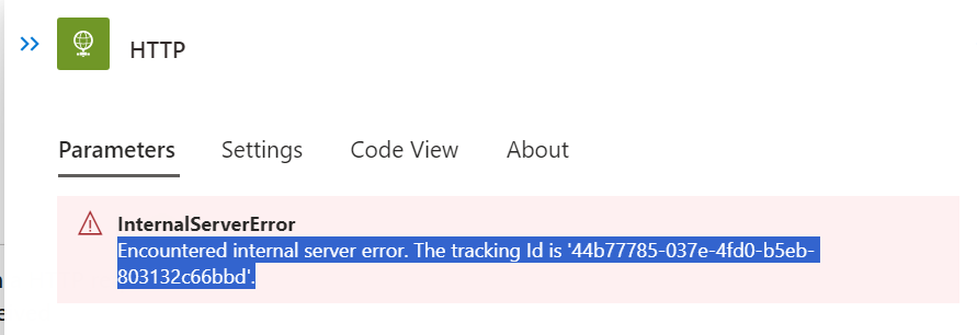

Getting below error:

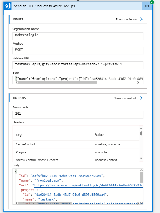

    @Vardhan Reddy Logic app already have the DevpOs connector which you can leverage to perform different operations. This connector already has the Send an HTTP request to Azure DevOps where you can build the request as per the DevOps REST API document in case if the action is not available.
    If you are getting 401 error, then make sure you have Third-party application access via OAuth option enabled. For more screenshots and details refer to this.
    Just for your reference I have tested the request and created the repository in my project as per the screenshot below.
    Make sure you are building the request and request URI correctly else you may get 401 error if you are hitting the wrong endpoint.
