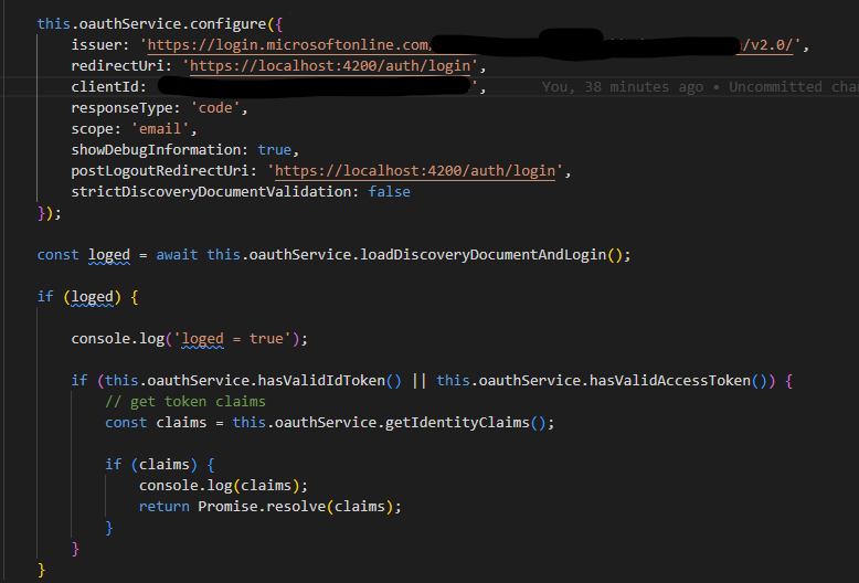

I have application based on Angular 16, for authentication is used angular-oauth2-oidc V15.0.1 (https://www.npmjs.com/package/angular-oauth2-oidc).
It worked well with MyID Login service.

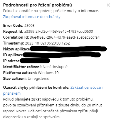

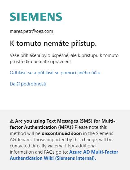

But now I´m getting this error and dont get tokens:
You do not have access to this.
Your login was successful, but you do not have permission to access this resource.
In detail I see only:
No other errors are there.
My code:
I have checked settings for configuration in aplication, and in administration too.
Tried many changes for responce type, scope ... but no improvement.

  1. Alfredo Revilla - Upwork Top Talent | IAM SWE SWA 27,536 Reputation points Moderator
    2023-10-02T23:28:07.9966667+00:00
    Hello @Anonymous , the Entra ID (formerly Azure AD) AADSTS53003 is caused by one ore more Conditional Access policies blocking you from signing in or accessing a resource. In your specific scenario it were 3 policies. For more information or how to avoid facing this issue again please reach one of your tenant admins.
