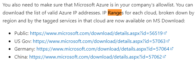

Some other guide talks about whitelisting entire Azure CIDR range for that region also couple of other URLs such as below.
*.servicebus.windows.net
*.core.windows.net
*.database.windows.net
Can someone please help us to get the correct port & firewall requirements for ADS & integration runtime in such restrictive environment? Your help is highly appreciated. User's image
