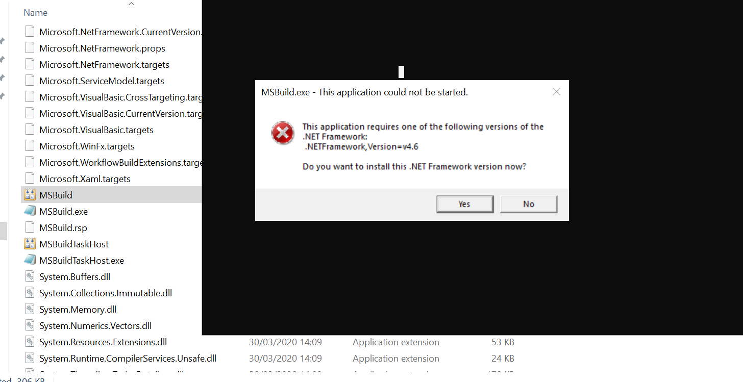

  2. Now I'm not able to open "C:\Program Files (x86)\Microsoft Visual Studio\2019\BuildTools\MSBuild\Current\Bin\MSBuild.exe" ,this msbuild.exe is throwing following error window " MSBuild.exe requires following .net framework version==4.6" .its failing with same error on all the new servers been installed with VS2019 on windows 2019 server.
    The thing is I have all the .net framework packages from 3,3.5,4.6.2,4.7,4.72 and 4.8 installed on the server, but MSBuild.exe is looking for 4.6 version which is also installed on the server but unable to locate it. So seeking your expertise to find out a right fix. Appreciate your help on this issue!

    Did you modify some .config files or some settings, maybe by mistake?
    Please right-click MSBuild.exe.config file and click Open With => Choose another app => select Notepad => confirm that the supported runtime version of this line:  <supportedRuntime version="v4.0" sku=".NETFramework, Version=v4.6" /> is set to v4.0.
