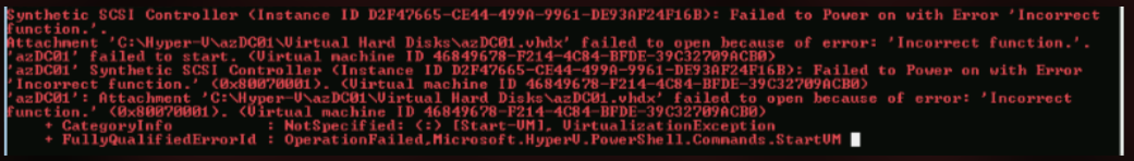

    [Content]
    'azDC02' failed to start.Synthetic SCSI Controller (Instance ID 6B5F6BE4-DEC2-4A11-8FD6-E77205FDF6EA): Failed to Power on with Error 'Incorrect function.'.Attachment 'C:\Hyper-V\azDC02\Virtual Hard Disks\azDC02.vhdx' failed to open because of error: 'Incorrect function.'.[Expanded Information]
    'azDC02' failed to start. (Virtual machine ID B4A7FC43-676C-4DC2-9604-9ABC83DB7B2A)'azDC02' Synthetic SCSI Controller (Instance ID 6B5F6BE4-DEC2-4A11-8FD6-E77205FDF6EA): Failed to Power on with Error 'Incorrect function.' (0x80070001). (Virtual machine ID B4A7FC43-676C-4DC2-9604-9ABC83DB7B2A)'azDC02': Attachment 'C:\Hyper-V\azDC02\Virtual Hard Disks\azDC02.vhdx' failed to open because of error: 'Incorrect function.' (0x80070001). (Virtual machine ID B4A7FC43-676C-4DC2-9604-9ABC83DB7B2A)[^] Hide details [Close]
