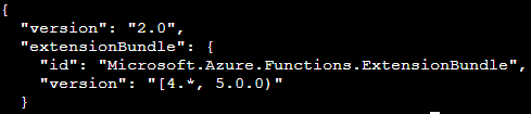

I did notice that this host.json was created in wwwroot and it the only file there:
enter image description here
