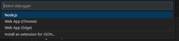

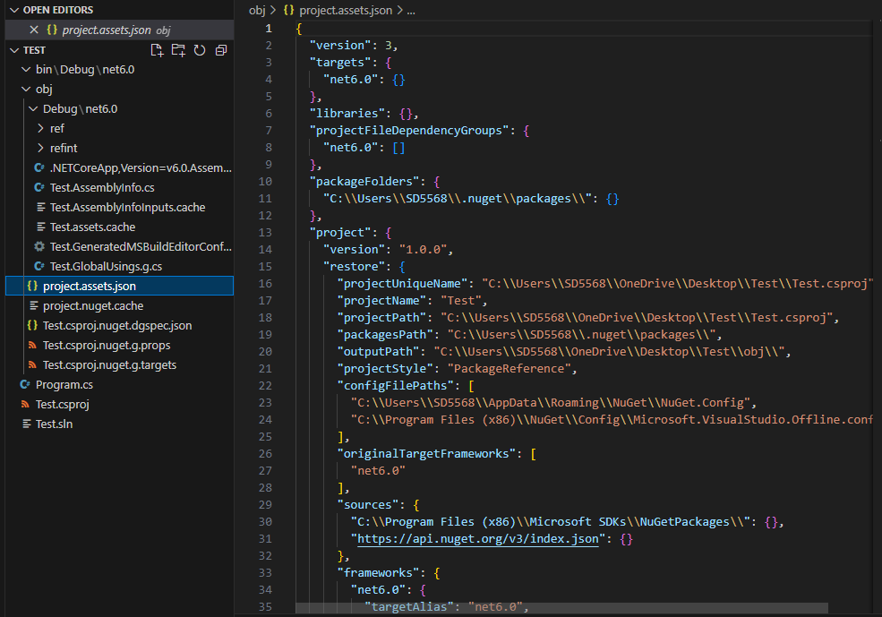

I am following the instructions below in a .cs file & trying to launch the debugger. However I can not find the option for .NET 5+ and .NET Core. Please help.
  1. Open the Run menu.
  2. On the Run menu, select Add Configuration.
  3. To choose the debugger option for your console app, select .NET 5+ and .NET Core.

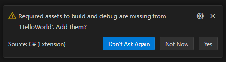

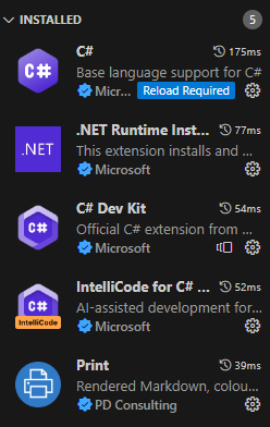

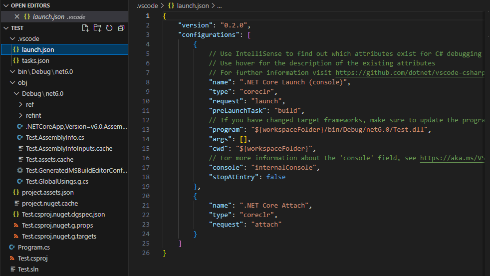

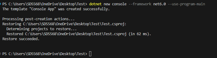

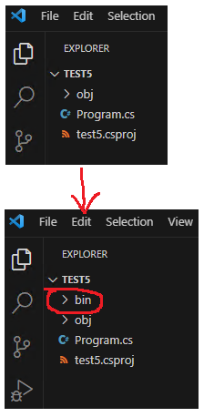

    Please first confirm if you are using Visual Studio(VS) or Visual Studio Code(VS Code).
    The instructions you are following should be for VS Code.
    If you are using VS Code, and you didn’t find the .NET 5+ and .NET Core option, then please keep VS Code open and try again. Click Run, select Add Configuration and check if this time, the .NET 5+ and .NET Core option appears.
