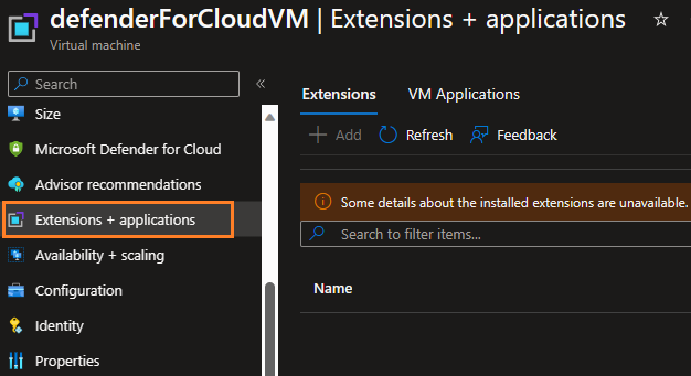

  2. JamesTran-MSFT 36,906 Reputation points Microsoft Employee Moderator
    2023-10-18T19:53:10.0433333+00:00
    @Paul Cowan
    Thank you for your post!
    To hopefully help point you in the right direction - if your VM is leveraging the Key Vault for an SSL Certificate, you should be able to remove the Key Vault reference from your VM by uninstalling the respective Extension (i.e. Key Vault or IIS).
    • Note: If you're having issues removing the VM through the Portal, you can also leverage the Azure Cloud Shell.
    For more info - Troubleshooting Azure Windows VM extension failures
    1. Open the Azure portal and navigate to the virtual machine that is referencing the Key Vault.
    2. Click on Extensions under the "Settings" section of the virtual machine.
    3. Find the respective extension used for your SSL certificate (i.e. Key Vault or IIS).
    4. Select Uninstall to remove the extension.
    Once you have removed the reference to the Key Vault from your VM, you should be able to delete the Key Vault without any issues.
    • If you're still having issues and would like to work directly with our support team through a one-time free technical support request, please let me know.
    Additional Links:
    I hope this helps!
    Thank you for your time and patience throughout this issue.
    If the information helped address your question, please Accept the answer. This will help us and also improve searchability for others in the community who might be researching similar information.
