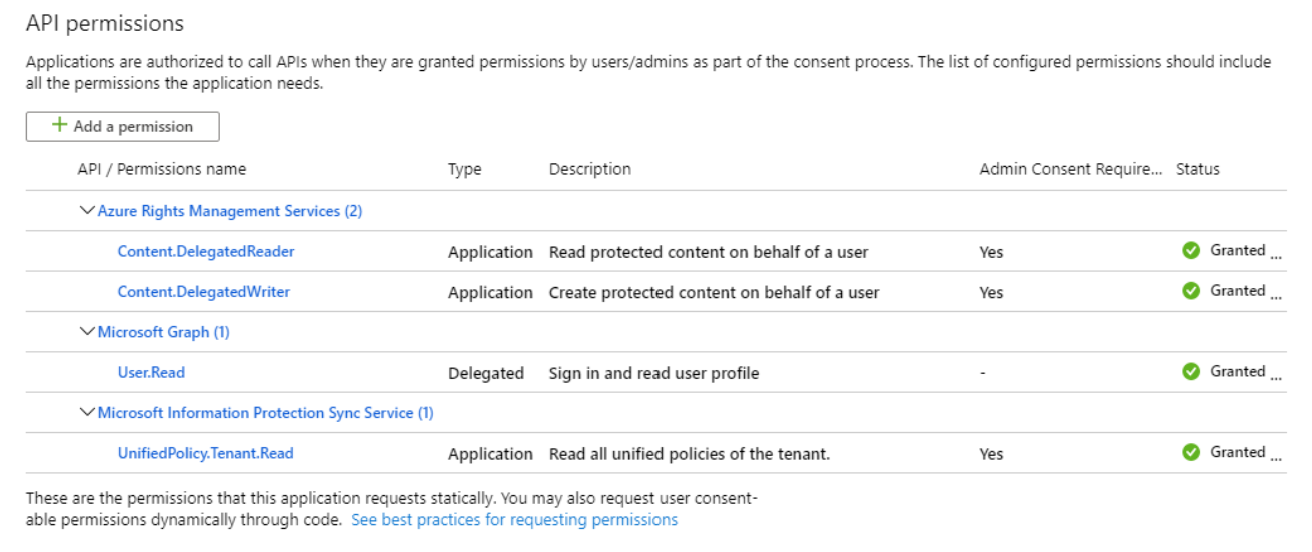

    In addition, I would recommend checking the AD application settings and validating if the API permissions are set correctly. https://learn.microsoft.com/en-us/azure/information-protection/rms-client/clientv2-admin-guide-powershell#create-and-configure-azure-ad-applications-for-set-aipauthentication
