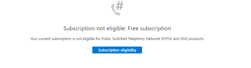

Your current subscription is not eligible for Public Switched Telephony Network (PSTN) and SMS products.
Yevhenii Zakharenko 0 Reputation points
2023-10-27T09:14:43.4466667+00:00
Hi
I need to use the feature to send SMS. I have the problem when I want to use Telephony and SMS>Phone Numbers in Azure Communication Services.

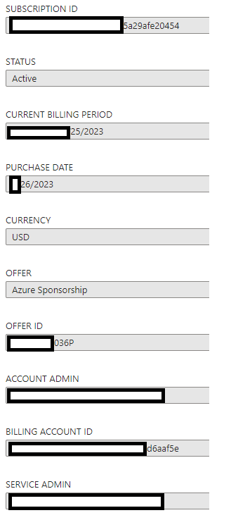

Looks like the prerequisites are fulfilled (could you please check in logs maybe I don't have access to view).
The client checked and the billing account address is USA. Could you please help me what thing I need to change in my subscription to use this feature?

    Based on the shared information, I understand that your subscription is Azure Sponsorship offer and when you are trying to purchase a phone number it is showing that your subscription is not eligible to purchase the phone number.
    To purchase phone numbers in Azure Communication Services, you need to have a subscription that supports phone number capabilities. Currently, phone number capabilities are available in the following subscription offers:
    • Modern Customer Agreement (Field and Customer Led)
    • Modern Partner Agreement (CSP)
    • Enterprise Agreement*
    • Pay-As-You-Go
    Subscription eligibility offers changes based on the country in which you are trying to purchase the phone number.
    ** Applications from all other subscription types are reviewed and approved on a case-by-case basis. Reach out to acstns@microsoft.com for assistance with your application.
