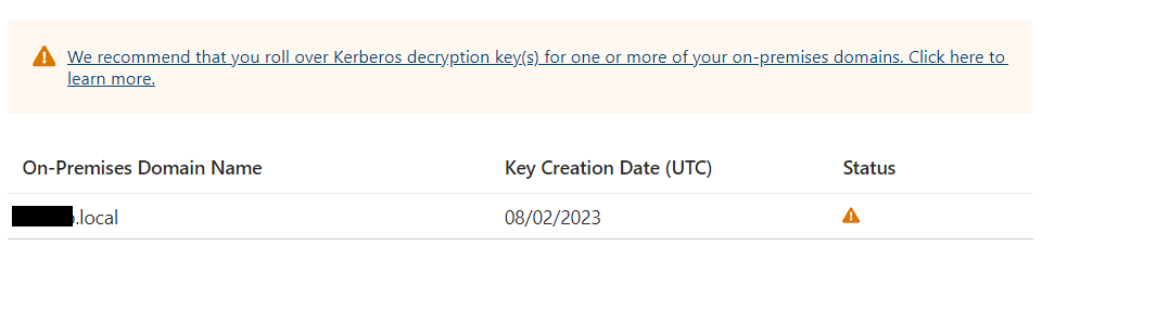

I was only new to IT and tested aad connect a year ago ... I lost all access to that server which i deleted not thinking aad connect would still be running... i need a slap on the wrist for this one...
I have managed to use a powershell command to manually stop the sync but i still have the sso config showing it is still connected to the old test domain...
Since this is going on I am not able to add a new azure ad connect sync from my new on-prem server.
Would appreciate the help if anyone can help :)

    If you want to Turn off directory synchronization for Microsoft 365 you must execute this command:
    Set-MsolDirSyncEnabled -EnableDirSync $false
    If you want to reactivate the credential synchronization between your local AD and your Microsoft Entra ID, you must reinstall the Azure AD Connect.
    If you still have errors, please share the error log output.
