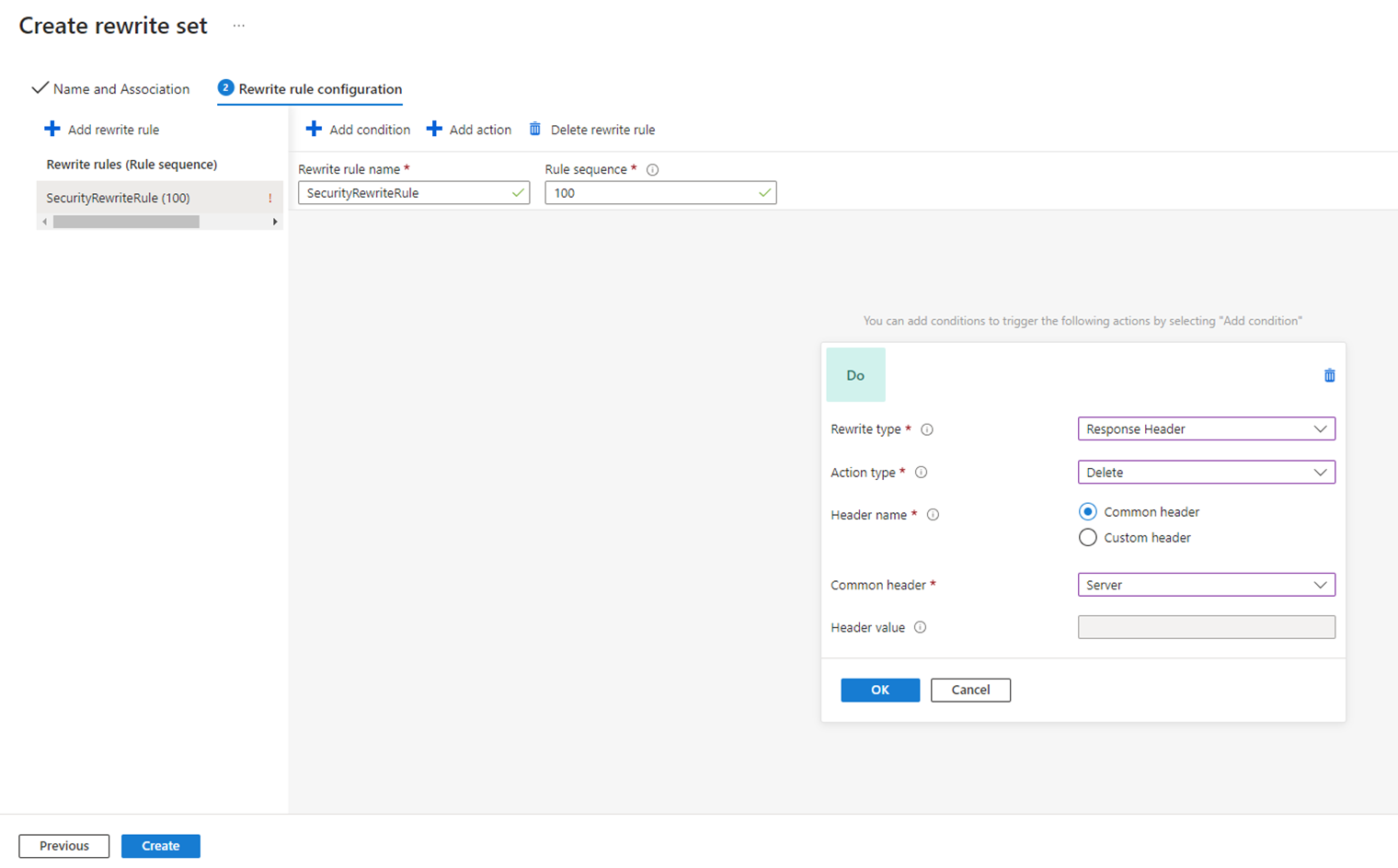

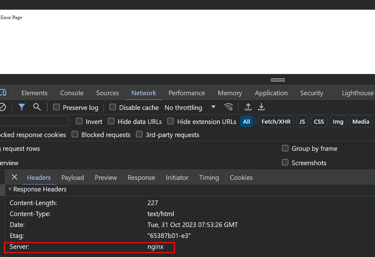

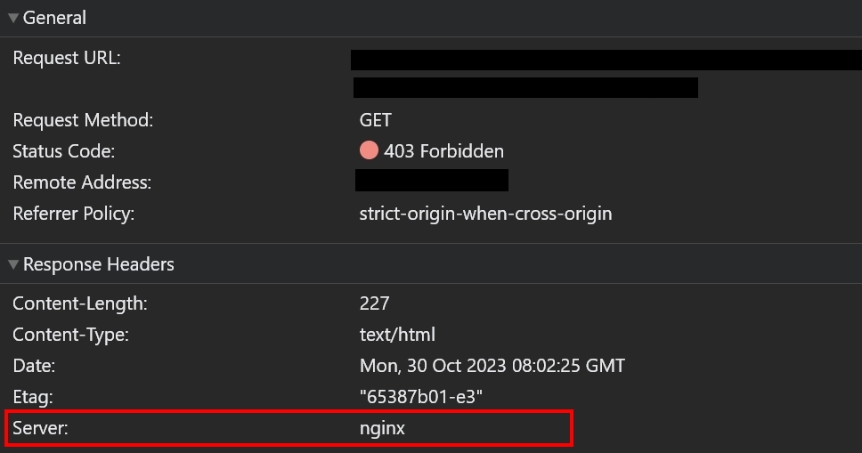

We encountered a problem with pentesting. Found issue about server information "nginx" when application gateway response. I created an application gateway of WAF tier, I implement rewrite set for remove "Server" in response.User's image
It works correctly at status 200, but state 403 still contains data for nginx

    I understand that you are facing an issue with Application gateway WAF where the server information is being disclosed in HTTP response header of 403 error and you are unable to implement rewrite set for same.
    As mentioned in the Application Gateway header rewrite limitations,
    Rewrites aren't supported for 4xx and 5xx responses generated directly from Application Gateway

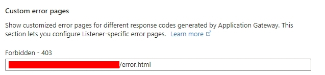

    So, maybe you can take a look into Custom error pages supported by Application gateway in this case.
    Application Gateway allows you to create custom error pages instead of displaying default error pages. You can use your branding and layout for errors related to different response codes.
    You can define customized error pages for different response codes returned by the Application Gateway. The response codes for which you can configure error pages are 400, 403, 405, 408, 500, 502, 503, and 504. You can use global-level or listener-specific error page configuration to set them granularly for each listener.
    To create a custom error page, you should:
    • know the response code for which a custom error page is needed.
    • know the corresponding remote location (URL) for the HTML page. This must be a publicly accessible file.
    • ensure the error page is publicly accessible and return a 200 response.
    • ensure the error page should be in *.htm or *.html extension type.
    • ensure the page size is less than 1 MB.
    • You may reference internal or external images/CSS for this HTML file. For externally referenced resources, use absolute URLs that are publicly accessible. Be aware of the HTML file size when using base64-encoded inline images, JavaScript, or CSS.
    Refer:
    https://learn.microsoft.com/en-us/azure/application-gateway/configuration-listeners#custom-error-pages
    https://learn.microsoft.com/en-us/azure/application-gateway/custom-error
