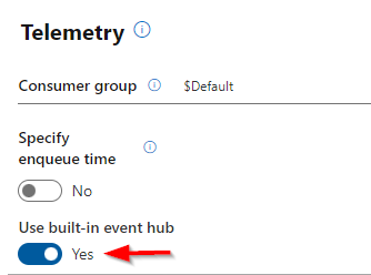

    not able to view the data in the IOT explorer
    Based on the information you have shared, it is highly likely that you are routing events to a custom End point on IoT Hub, which you are using to trigger the Azure function. In Azure IoT Explorer, when you try to view telemetry on a device, the default option that is selected for monitoring is built-in Event Hub end points. Please refer the below image to find this setting.
    You can disable this setting and provide your Custom Event Hub endpoint to view telemetry through Azure IoT Explorer. You can also leverage Azure IoT Tools on Visual Studio Code to monitor custom endpoints. If you are new to the IoT Hub routing and would like to get more understanding on this concept, please refer to the following resources.

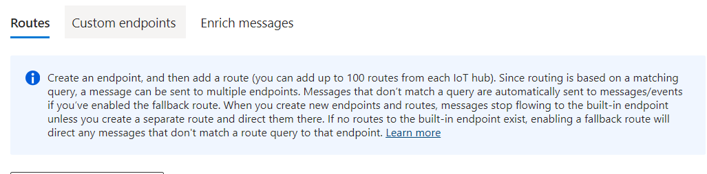

    By default, messages are routed to other services using the 'eventhub compatible endpoint'.
    This endpoint is used by the Azure IoT Explorer.

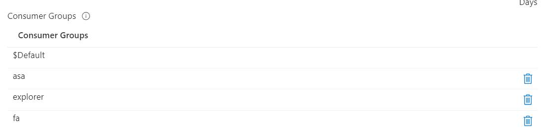

    Note: it is recommended to give every consuming service its own consumer group. This way each consumer gets its'own copy of incoming messages:

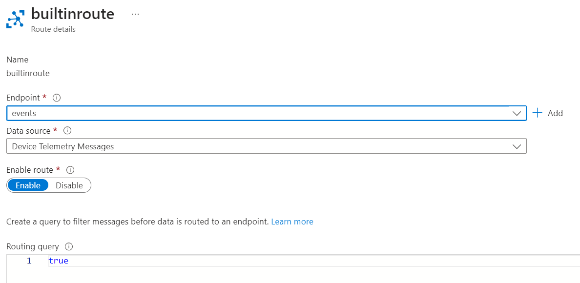

    If you add new routes to the IoT Hub eg. to an Event Hub, or CosmosDB, that original endpoint will start behaving as a fall-back route. When not a single route is picking up an incoming message, it will be sent to the default events endpoint.
    Please add an extra route for this endpoint and the original functionality is restored:
