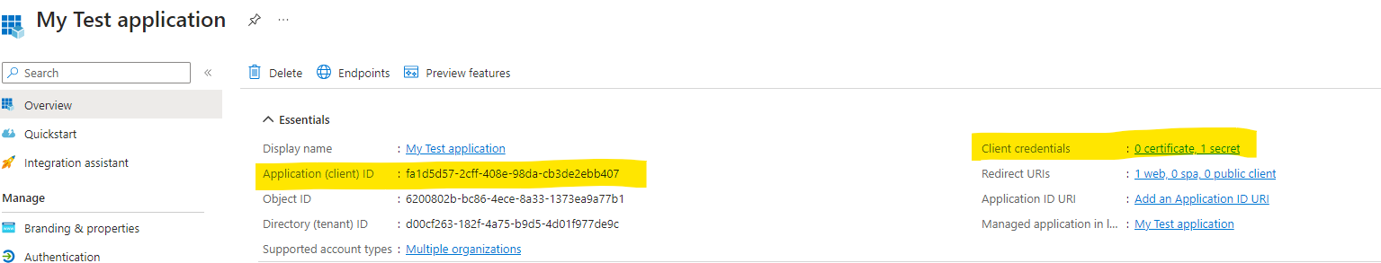

  1. Shweta Mathur 30,296 Reputation points Microsoft Employee Moderator
    2023-11-06T11:15:51.25+00:00
    Hi @David Aw ,
    Thanks for reaching out.
    It seems you are trying to fetch Key Vault's secret and facing an issue while fetching the credentials.
    I can see you have used UsernamePasswordCredential and DefaultAzureCredential classes to authenticate the requests.
    If you are working in Visual Studio, then vsual studio sometimes don't pick the credentials which causes this error.
    In Visual Studio, go to Tools > Options. Expand "Azure Service Authentication" > "Account Selection." If you see a "Reenter your credentials" link, click it and sign in again. If not, try a regular sign-out + sign-in via your Visual Studio profile in the top right.
    Alternatively, you can authenticate yourself by creating a service principal and setting client secret for that application and then connect with key vault to retrieve the value.
    Reference to create service principal-
    https://learn.microsoft.com/en-us/entra/identity-platform/howto-create-service-principal-portal
    You can get the client id and client secret of the application when you registered your application.
    Hope this will help.
