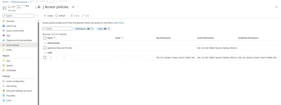

My account has the "Contributor" access to the subscription, also has "Application Developer" role. Our resources are in a private endpoint.

    If possible change to Owner instead of Contributor
    Or else
    Add the permissions to Azure Key Vault as per :
    https://learn.microsoft.com/en-us/azure/key-vault/general/assign-access-policy?tabs=azure-portal

    Since ours is a shared subscription, so DNS configuration on the private endpoints had to be changed to shared "Private DNS zone", once this was done. I was able to register the appliance.
