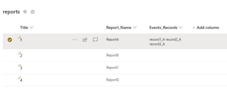

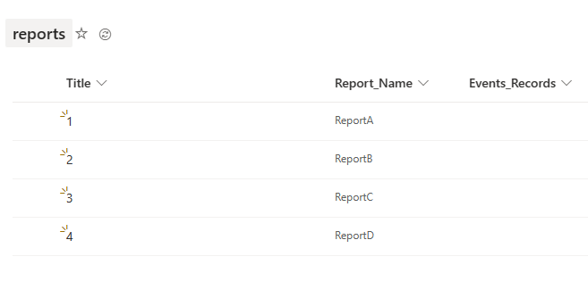

    I have created two lists: reports and events. Since I am not sure what record you want to reference from the events list, in my testing I set it to a single line of text. Don't worry if you want to reference a different type than I do (Date or otherwise), this is just an example, and you can specify the type you want to reference later depending on what you actually need.
    There are three events_record messages about ReportA in the events list, are you trying to add these three records to the Events_Records column of the ReportA row in the reports list? Like down there?
    Correct me if I am wrong.
