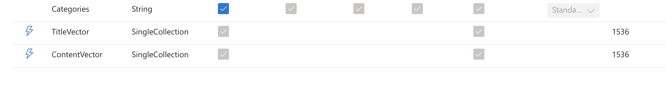

Although I have passed the correct vector filed

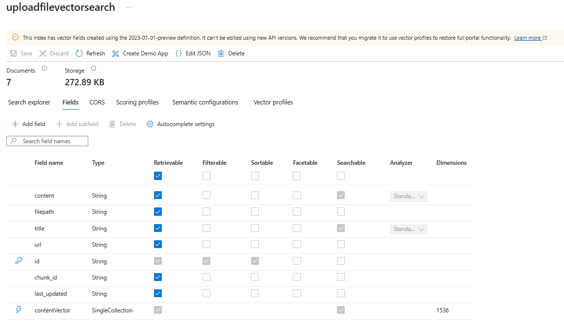

  1. Jacob Thomas 55 Reputation points
    2023-12-11T16:57:35.65+00:00
    I made a separate post since this one wasn't getting anywhere, and was eventually able to figure out the issue myself. For whatever reason the fieldsMapping property was required for my requests to the API. I imagine this might have something to do with the fact that I have more than one vector field, or maybe because my vector fields aren't named "vector"? Not sure exactly, honestly, and Microsoft's documentation is no help on explaining why this might be the case, but I would give it a try considering how similar this post is to my own. You can view my original post below
    https://learn.microsoft.com/en-us/answers/questions/1458065/how-to-configure-cognitive-search-index-vector-fie?page=1&orderby=helpful#answers

    Solution: "I just figured it out. It seems that the "fieldMapping" property is required for vector embeddings, at least with how my vectors are configured. If I had to guess it might have to do with the fact that I'm using two vector fields, but the property is supposed to only be required for the Azure Cosmos DB/MongoDB... at least according to the documentation. Below is the property format I used to get the request working."
    "fieldsMapping": {
                      "vectorFields": [
                          "titleVector",
                          "contentVector"
    Please 'Accept as answer' and Upvote if it helped so that it can help others in the community looking for help on similar topics.
