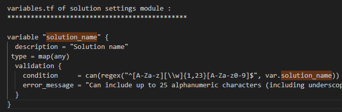

Need help in terraforming the code (azure keyvault )with the specific naming conventions
Attached the code in the text file.
I have below terraform code, need help in identifying which value to be given for a specific solution_settings variable and the code should work as I am new to Terraform.

    Thank you for your post and I apologize for the delayed response! To hopefully help point you in the right direction, I'll share my findings based off your Terraform script and error messages below.
    Error Message 1:
    Error: Unsupported attribute on main.tf line 2, in locals: 2: key_vault_name = coalesce(var.key_vault_name, module.solution_settings.key_vault_name) module.solution_settings is a object. This object does not have an attribute named "key_vault_name".
    This error message indicates that the object module.solution_settings doesn't have an attribute named "key_vault_name". This suggests that the key_vault_name variable is not defined in the solution_settings module.
    • When looking into your variables.tf file of the solution_settings module, it looks like you set the default key_vault_name variable as an empty string. Can you make sure that the key_vault_name variable within the Module Solutionsettings was correctly set?
    • I notice you're trying to set it to key_vault_name = "${local.name_prefix}akv"
    Error Message 2:
    Error: Invalid value for input variable on solutionsettings.tf line 4, in module "solution_settings": 4: solution_name = "testmm" The given value is not suitable for module.solution_settings.var.solution_name declared at solutionsettings\variables.tf:1,1-25: map of any single type required.
    The second error indicates that the solution_name variable is not the correct type. The solution_name variable is defined as a map of any single type, but the value provided (testmm) is a string.
    • Can you make sure you used the correct value or type when it comes to the solution_name variable?
    Error Message 3:
    Error: Invalid value for variable │ │ on solutionsettings.tf line 10, in module "solution_settings": │ 10: tags....
    The last error message is regarding issues with the tags variable. When referencing our Microsoft.KeyVault vaults Terraform script, I noticed that each tag is written with an "equals =" sign but within your Terraform script you're using a "colon :".
      tags = {
        tagName1 = "tagValue1"
        tagName2 = "tagValue2"
    • Can you ensure that the tag values are correct and see if updating the sign value helps to resolve this error?
