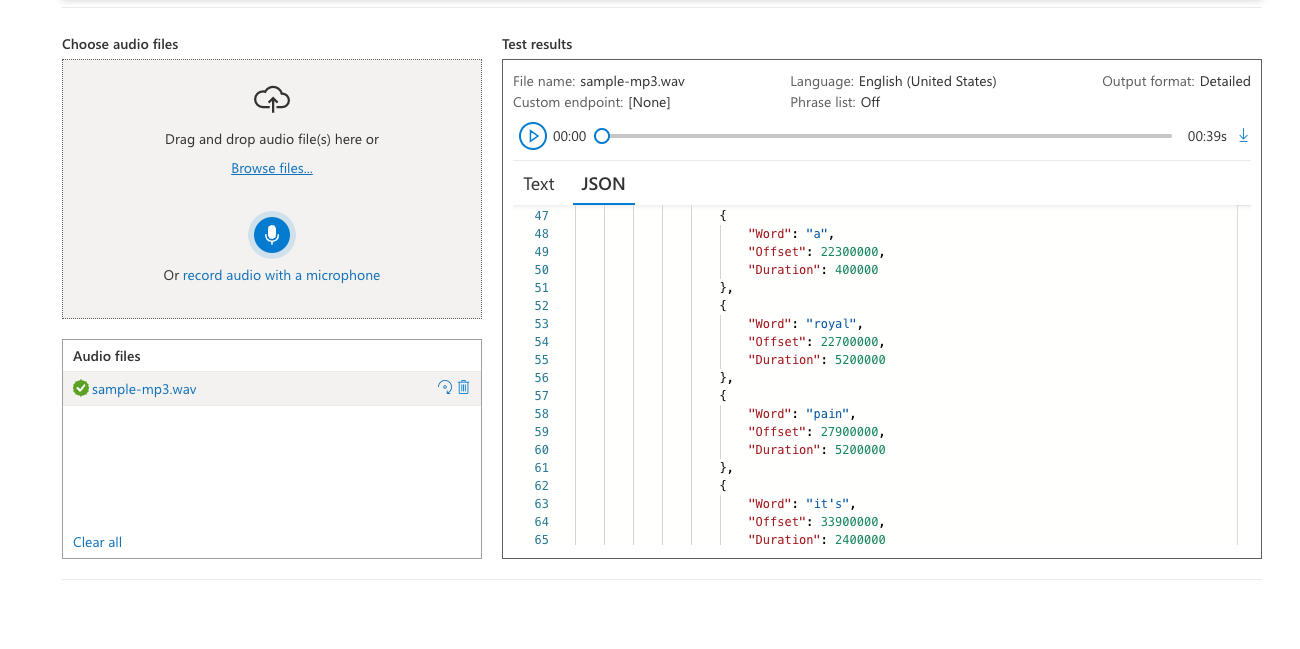

I want this JSON object in my react project when I use the Azure Speech SDK. How can I get this?
The issue I have with the JS SDK is that the word level timestamps are not accurate, some offset-duration combos has 2 words. I need exact word by word durations at least. And I only see that here in this JSON object.
What is the right solution to get this word by word durations?

    Issue:
    You are looking for a solution to get word-by-word durations using the Azure Speech SDK. You have mentioned that the word level timestamps are not accurate and you need exact word-by-word durations.
    Resolution:
    The correct answer to this, without having to do batch transcriptions and using the JS SDK itself, is to use pronunciation assessment. On activating pronunciation assessment, the results give the offset and duration for each and every word in the speech.
    Related documentation to activate pronunciation assessment is here: https://learn.microsoft.com/en-us/azure/ai-services/speech-service/how-to-pronunciation-assessment?pivots=programming-language-javascript
