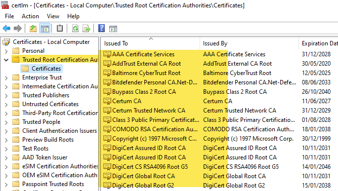

  3. Jatin Makhija 1,181 Reputation points
    2023-11-29T16:37:13.7566667+00:00
    To enable this option and execute PowerShell scripts successfully, ensure the following:
    1. Use a Code Signing Certificate to Sign your PS Script.
    2. Ensure that the root of the Code Signing Certificate is Installed on the target Windows device in the Trusted Root Certificate Authorities store.
    Usually, when you utilize third-party CAs like Comodo or DigiCert to sign your PowerShell script, the root certificate is already present on your Windows device. In such cases, there's no need to deploy it, eliminating one additional step.
    Unless you have this setup in place, you can choose Enforce script signature check - No to make sure your custom scripts are deploying and executing successfully on the target devices via intune.
    To access the Trusted Root Certification Authorities folder in Windows, press Windows + R, type certlm.msc in the Run box, and press Enter.
    ---If the response is helpful, please click "Accept Answer" and upvote it.---
