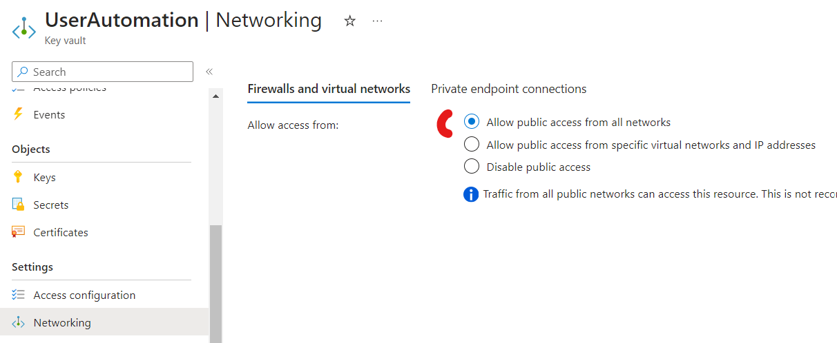

Hello,
I created a new key vault and when trying to view/manage secrets I get the error across the top of the page saying:
"The connection to data plane failed. Please refresh and try again. If Private Links are enabled on the vault and the issue persists please follow the steps in the following link https://go.microsoft.com/fwlink/?linkid=2156688"
I have 'Key Vault Administrator' access over the vault

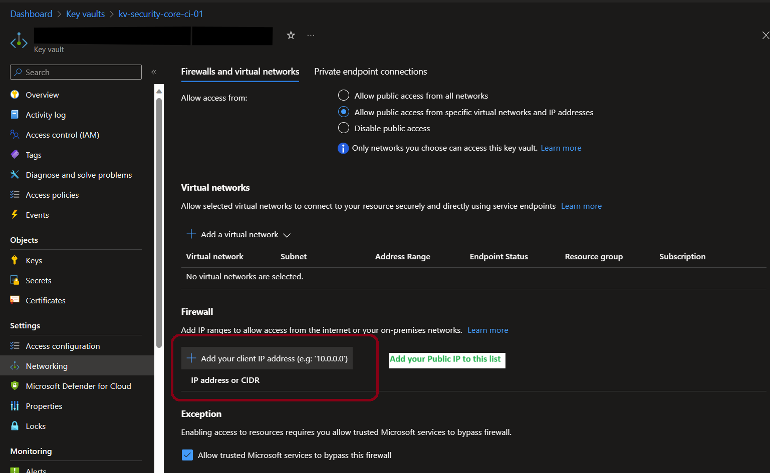

    The error message states that there is a problem with network connection between Azure key vault and client it could be following reasons.
    • A Firewall rule is blocking traffic to the Azure Key Vault. Check your firewall rules to make sure that traffic to the Azure Key Vault is not being blocked.
    • A connectivity issue between your client and the Azure Key Vault. Check the connectivity between your client and the Azure Key Vault.
